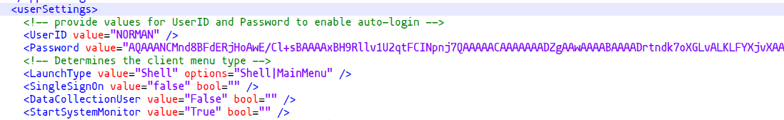

At some version of 10 (can’t remember which), they started encrypting the
password in the config file. So you can’t open a config file and edit the
user name and password directly like you use to be able too. You have to
click the Automatically Sign On option in the Preferences.
Which adds the entry to the config file and encrypts the password, like
this:
If you mess with the password in the config file, Epicor will reset both
UserID & Password to blank.

This check box will write their user name and scrambled password to the config files.

Update for Version 10.1.400.18. After checking the Automatic Sign On, do not go back and check the Single Sign On check box in the User account. This wipes out the settings in the config file and pops up an error stating single sign on will not allow you to login. Strange behavior but it works fine when the Single Sign On is unchecked.
