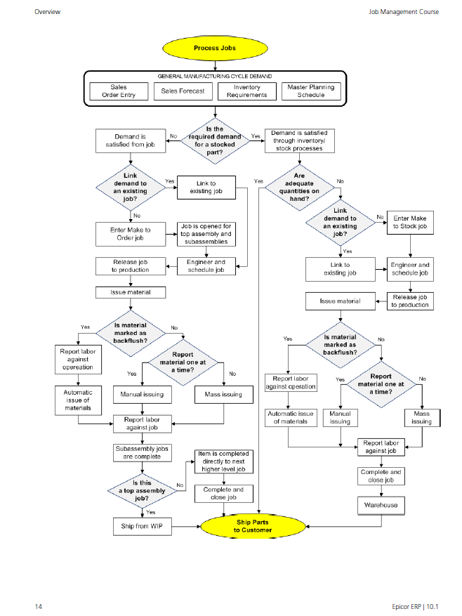

Are there any type of flowchart available for Epicor10 in regards to Job management module?
I know MRP creates unfirmed Jobs and you firmed them. What are the steps in order after that up to the Job Close ?
Would be nice to if they had that of something or am I missing that info somewhere?
This is from the 10.1 Job Management Course; is this what you’re looking for? Sorry it’s so small. I’ll provide a link to download the PDF below.
Pages from Job Management Course.pdf (103.3 KB)

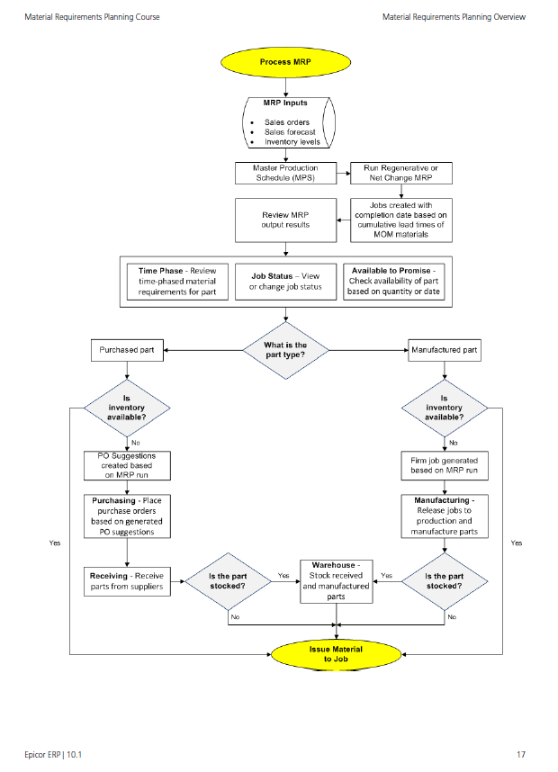

Here is one from the MRP guide as well.
Pages from Material Requirements Planning Course.pdf (82.7 KB)
