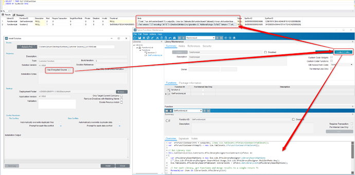

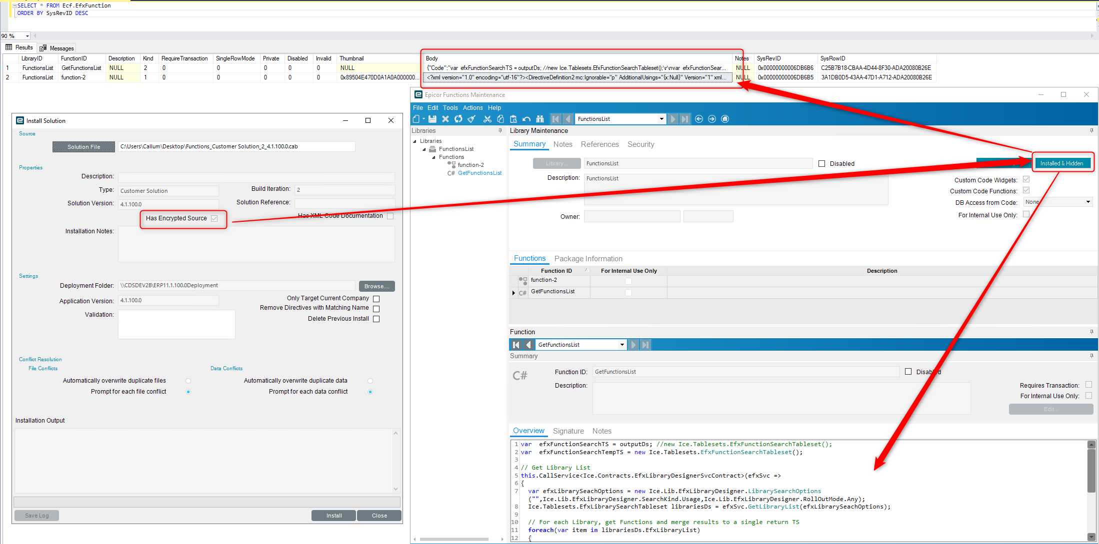

Re being able to encrypt a function: In 11.2 or 11.1? While I am aware of how to encrypt the solution package, I haven’t yet seen how we can encrypt an actual Epicor Function code in 11.1.
For example, as per below, when I exported a Function Library via Solution Workbench and imported it into another database, the custom code/function was still fully readable via Epicor Function Maintenance and at the database level. I get that with a widget function it’s no longer easily readable at the UI level but then it’s still easily readable at the database level.
