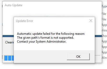

In 10.1.4XX you could set the deployment to HTTP and it worked just fine, however setting it to HTTP on 500 I keep getting this message
Assuming I haven’t’ forked anything up, does this mean that HTTP deployment is no longer allowed?

Yup that’s the way we’ve been doing it for ever (10.1.4XX) but for 10.1.500.7 it isn’t working (getting that error Above) if I use \Server\ it works fine (locally) but if I use http or ftp we get that error… I am showing you.

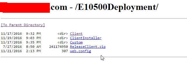

I can browse to the URL fine

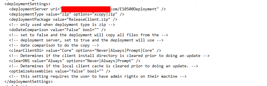

Current settings as follows
URL works, I can browse over to it (below)
Using fiddler I can see it hitting the Config URL and then it gives me the above error.
I reflected into the AutoUpdate.exe and didn’t see much its choking on StreamHelper class

The AutoUpdate.exe only supports http, not https
The issue I was running into was that the server config in http://myserver/deployment/client/config/myconfig.sysconfig was pointing to https. So even though my local AutoUpdate.exe was requesting the initial config from http, as soon as that config downloaded it re-read the sysconfig settings and tried to continue from https which throws a not supported error.
