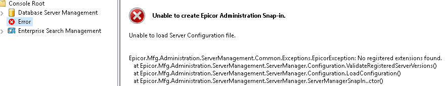

I am in the process of upgrading our environment from 10.2.100.12 to 10.2.400. As I am going through the documentation and after installing the latest version and upgrading one of the DB(Environments), I can not move forward with the application server update/registration as I do not see it in the Epicor Administration Console.
I get the following error with Unable to create Epicor Administration Snap-in. Unable to load Server Configuration File

Thank you for your reply. I did attempt all the above mentioned without success. it was giving me the following error:
Meanwhile, I also looked at the AdminConsolInstall file and noticed the that it was stating that the .NET Framework version v4.7.2 was required (I will review this as I did install). I did get a Custom Action Failed with code:‘1603’

Unfortunately I have not been able to uninstall the EAC, keeps giving me the error 1001 as stated above. And as such I run repair, I still am unable to see the Application Server Management

Can you go to Event Viewer (you will find it somewhere on your Start Menu) then under Custom Views -> Administrative Events - see if you have some more exception details.
Actually I used the Microsoft Program Install and Uninstall (Troubleshooter), and it was able to uninstall the EAC. I have now reinstalled from beginning and I can see Server Management within EAC, but no Application server.
You can just register it back or you can go to C:\ProgramData\Epicor\AdministrationConsole and modify the XMLs if they still have the old version info in them just modify it to 3.2.400 and 10.2.400 wherever you see old version references. If the XMLs are empty then you just have to re-register it via Admin Console.

I do not have anything in the Epicor.Mfg.Administration.ServerManagement.Configuration.xml, but I did back everything up and do have the previous xml which does contain the information
I was getting this same error, but I was not doing an upgrade. I confirmed no windows updates had been applied to the server and no other software changes had been made.
I backed up the C:\ProgramData\Epicor\AdministrationConsole folder then deleted the contents of the folder, 3 xml files.
EAC lauched w/o error.
I registered the database and existing application servers and everything and everything is working.
