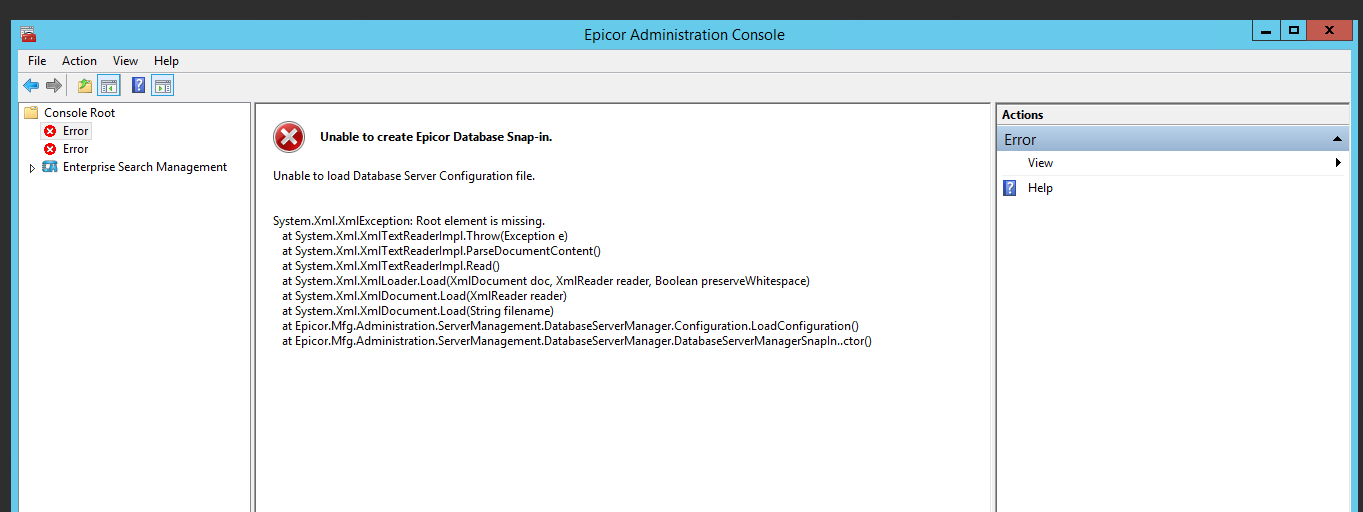

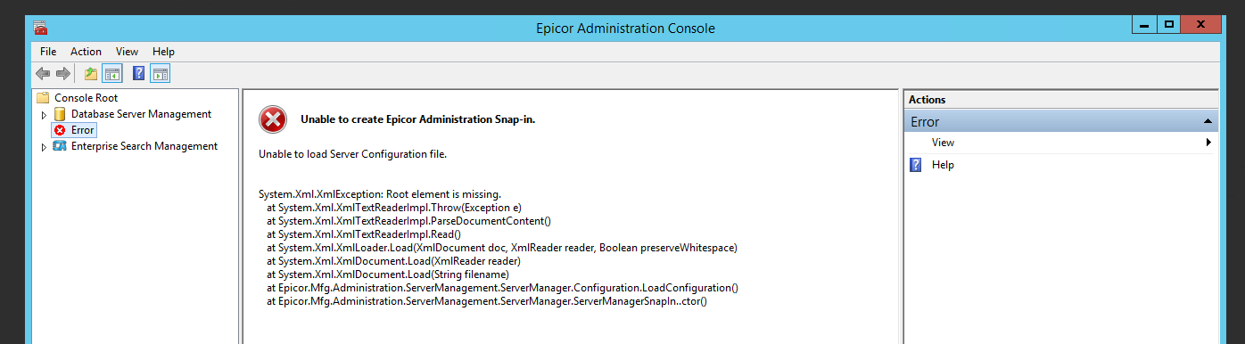

This is on my test server but still alarming. I can access Epicor fine but when on the server i get this when I open the Admin Console. Anyone seen this before?
got part of my answer from Epicor.
From Support:
navigate to C:\ProgramData\Epicor\AdministrationConsole
delete the xml files for databaseservermanagement and servermanagment
relaunch Epicor Administration Console
I did this and Admin Console opens fine now but I don’t have my DB or App server listed.

Steps clarified to to fix issue.
Closed admin Console
Browsed to C:\ProgramData\Epicor\AdministrationConsole
Deleted the following files (Can move to another location for safety)
  • Epicor.Mfg.Adinistration.DatabaseServerManagement.Configuration.xml
    and
  • Epicor.Mfg.Administration.ServerManagement.Configuration.xml
Once deleted re-launch Epicor Administration Console.
** you will need to re add the following**
Right Click on Database Server Management and click Add Epicor Database Server
then Register Existing Database
Right click on Server Management and Click add Epicor Server
then Right click on Epicor server and Register Application Server
What is corrupt is your local settings file for which servers you want to manage from that admin console. Think of it like a most recently used list.
