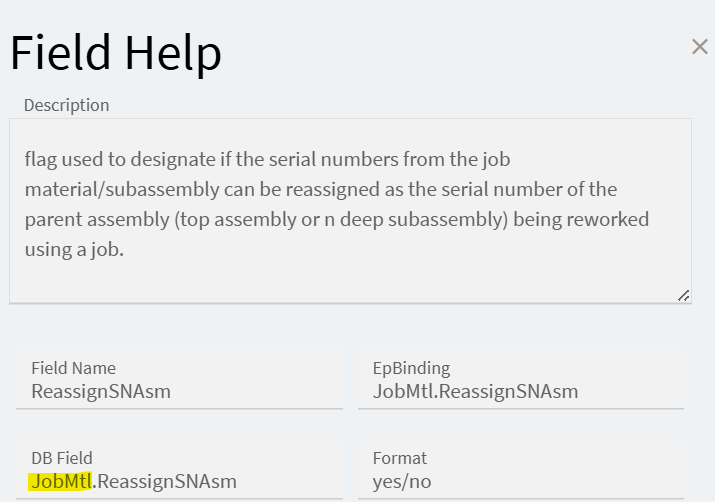

I would expect there to be the following check box somewhere in the process of creating the job and/or when issuing the material to the service job.
I think that’s only for assigning a serial number from job material as the serial number of the parent assembly. Or at least that’s the only place where I’ve seen it. We need the SN from the JobHead part.
Well, this would not be the first or last time something isn’t really thought through in Epicor.
Don’t you have to issue the part that you are servicing as a material? I could be wrong, but I am thinking of when an RMA gets put on a job. In those instances, part A is returned and dispositioned to a job that is for part A. So, you can flag it that the SN rolls up. It ends up being a circular reference, but that is allowed on RMA jobs. I thought that the service jobs worked the same way, but I could be wrong.
