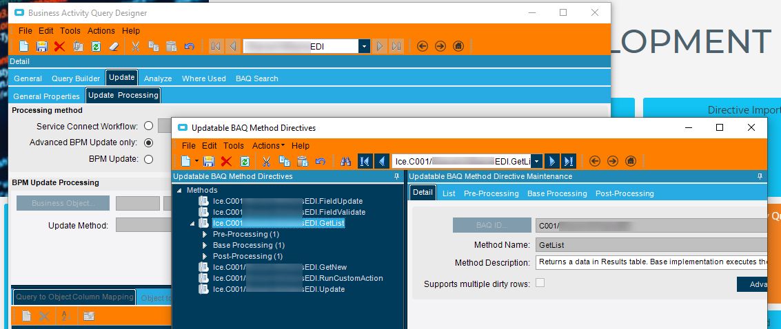

ouch - I use BAQ reports as a workaround to automate just about everything without paying for a scheduled process runner.
create a system agent task on a schedule…
create a UBAQ with a GetList directive containing any C# you want…
create a BAQ report using that UBAQ…
add a routing widget “generate report” …
run the report in BAQ report designer, saving it to the system agent task

@SteveFossey We do the same, but use the BAQ Export Process instead.
oh cool - that calls GetList?
Yessir. In fact, I’m working on one right now that will be scheduled that way.
