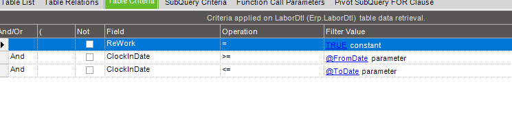

There isnt an out of the box report that I know of. I made a BAQ and dashboard using JobOpDtl and LaborDtl.
LaborDtl has a rework bool that you can use. when an employee clocks rework there are rework codes that you will need to set up for them to pick.
Alright thanks for sanity check. Yay more dashboards…! :expressionless:
