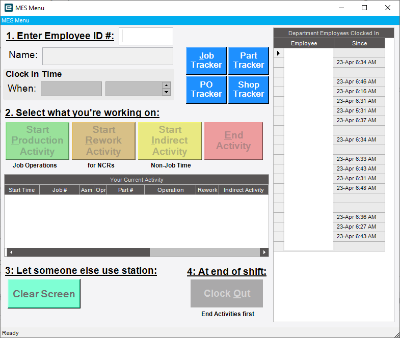

As far as the process, we either add rework operations to a job and clock to them, or use the rework button on our MES station to flag labor as rework. We’re not currently using Epicor for inspections or DMRs, though I would like to.
