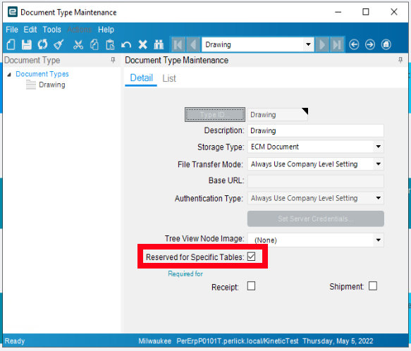

I’ve been able to get the SysRowID, my issue seems to be the Attach File to ERP datalink. The datalink needs to have the Reserved for Specific Tables unchecked (So the document can be added to any table in Erp) which I don’t want the data to get out of control so I want it contained.
We don’t use this checkbox, but it sounds like you need to ALSO associate the DocType with a Table using Document Type Control
See Epicor KB0117212 article. Please let us know if this works.
“Reserved for Specific Table” hasn’t worked since I started using docStar in 2018.
It would be great it that did work, so that when users are attaching documents within Epicor it doesn’t show them the full list, only the relevant ones!
That will be hardcoded in the workflow, so no users will be able to change it. In Epicor the document type will only show on the related tables.
