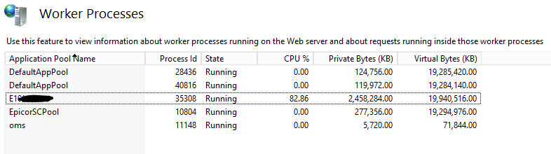

I noticed that my server is consuming 99% CPU.
When i further drill in, i realise the application pool worker process is running high. However, there is no request when i click in.

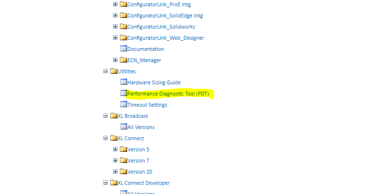

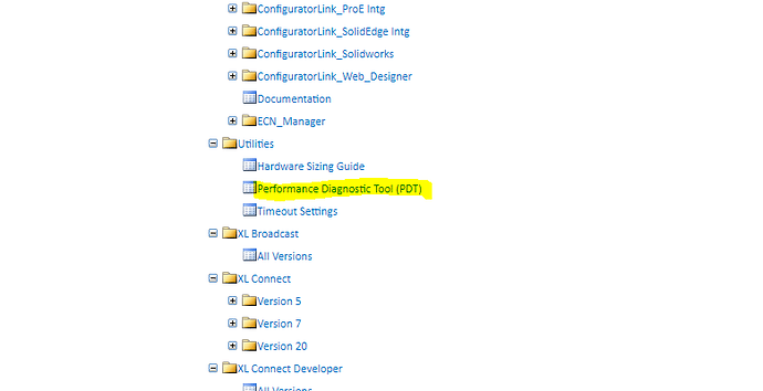

Run Performance Diagnostics tool.
where is this tool?
Epicor Downloads
