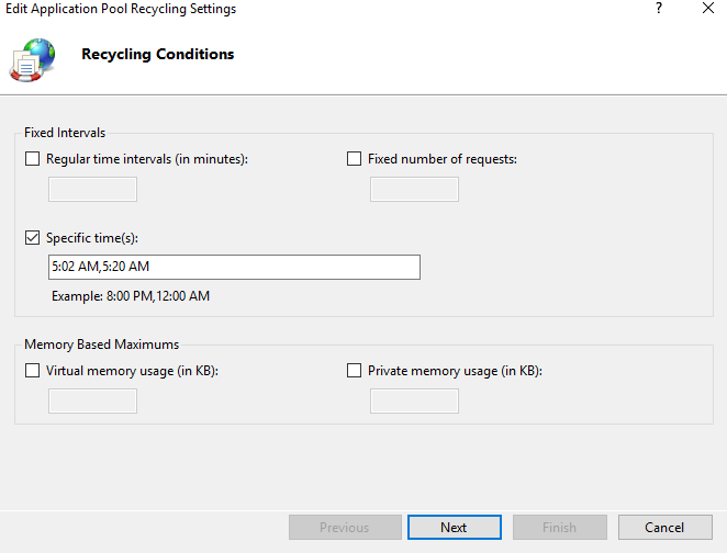

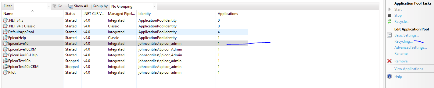

Could you please provide more details on the specific steps required to set up the automatic recycling of the application pool at approximately 5.00 am every morning, as mentioned in the second point?
Sure.
Go into IIS and select your Application Pool. On the pic below ours is EpicorLive10. In the right had pane select Recycling.
The next panel should pop up. Select the ‘Specific times’. I have entered two times; 5.00am and 5.20 am. Go through ‘Next’ and make sure ‘Scheduled time’ and ‘On Demand’ are ticked. This works for me.
That’s it.
I hope this helps.
