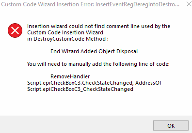

When I try to add the code I get this error.
This is the full Script:

epiShapeC1.Enabled = Not epiShapeC1.Enabled
This code should work, but I would offer that if you are using E10, you should move the code to C# anyway…
