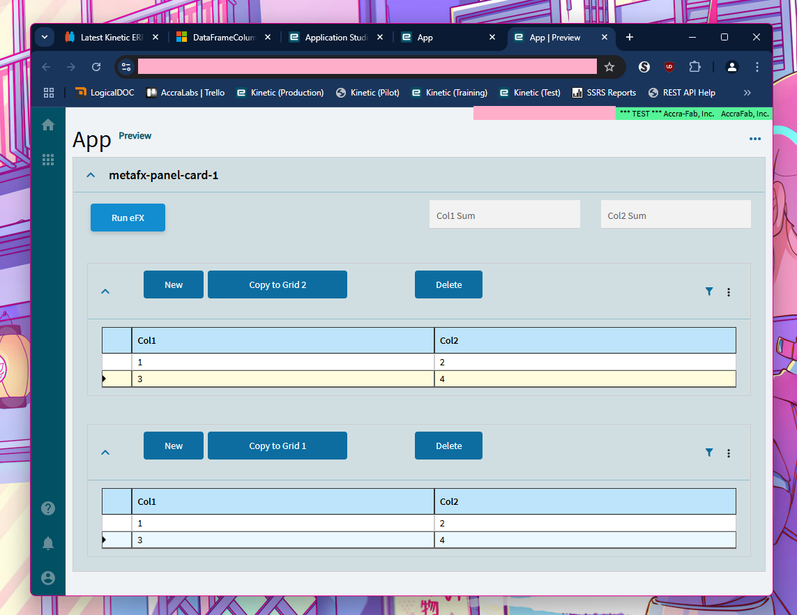

The two textboxes should be a sum of columns 1 and 2 when you click Run eFX.

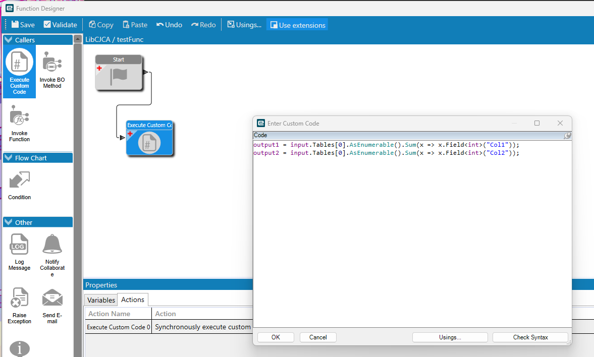

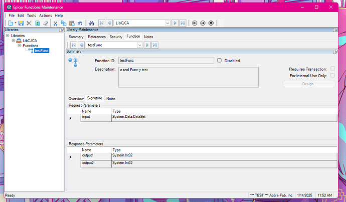

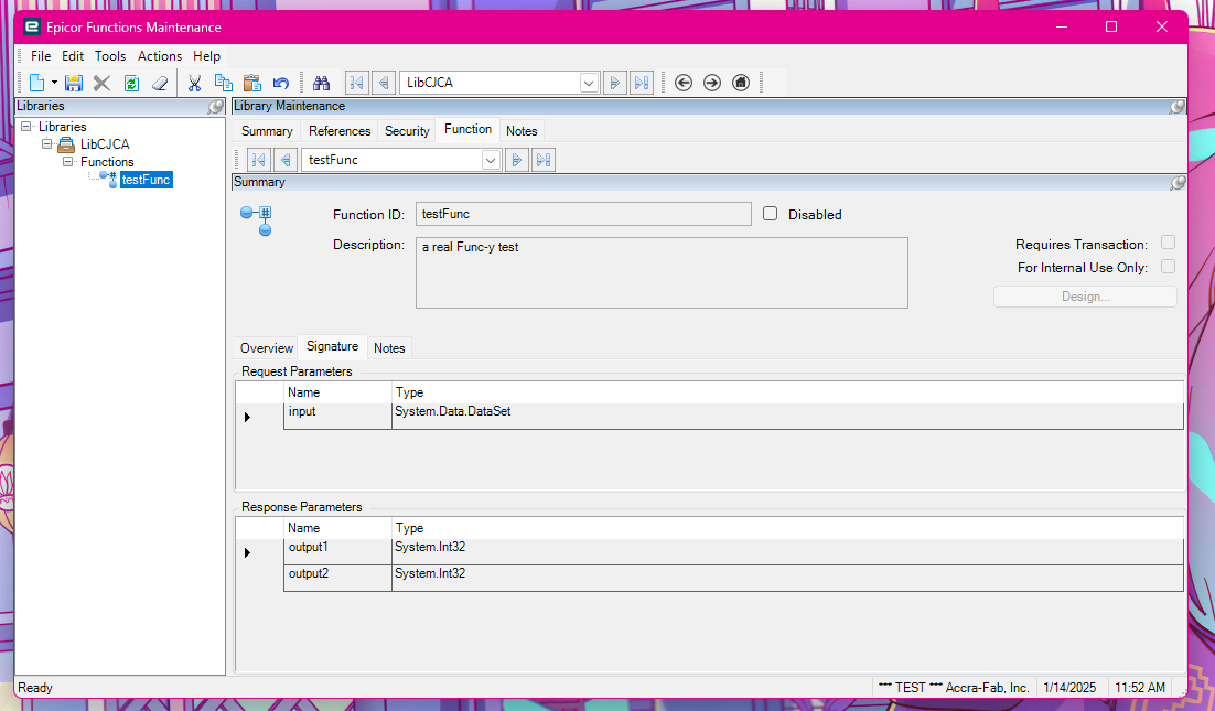

Here’s the function in question:

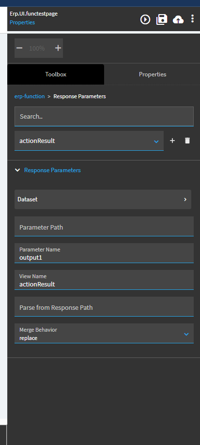

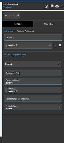

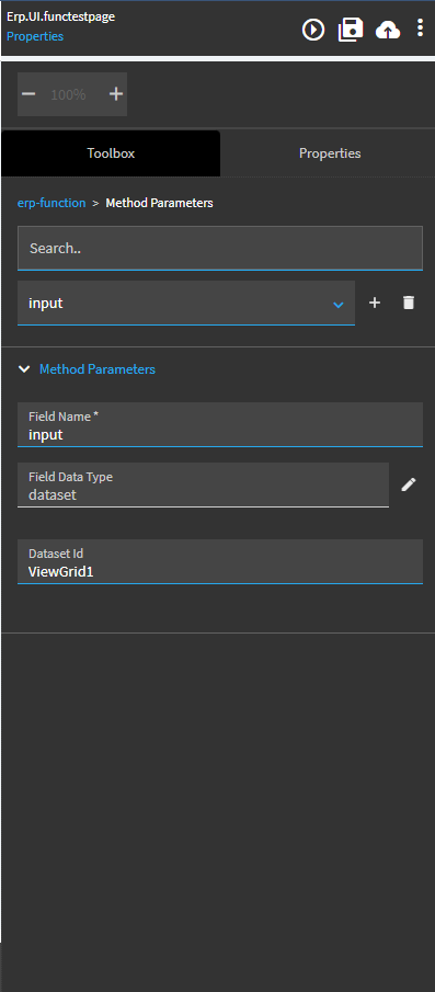

the ERP-function widget calling it is set up as shown:

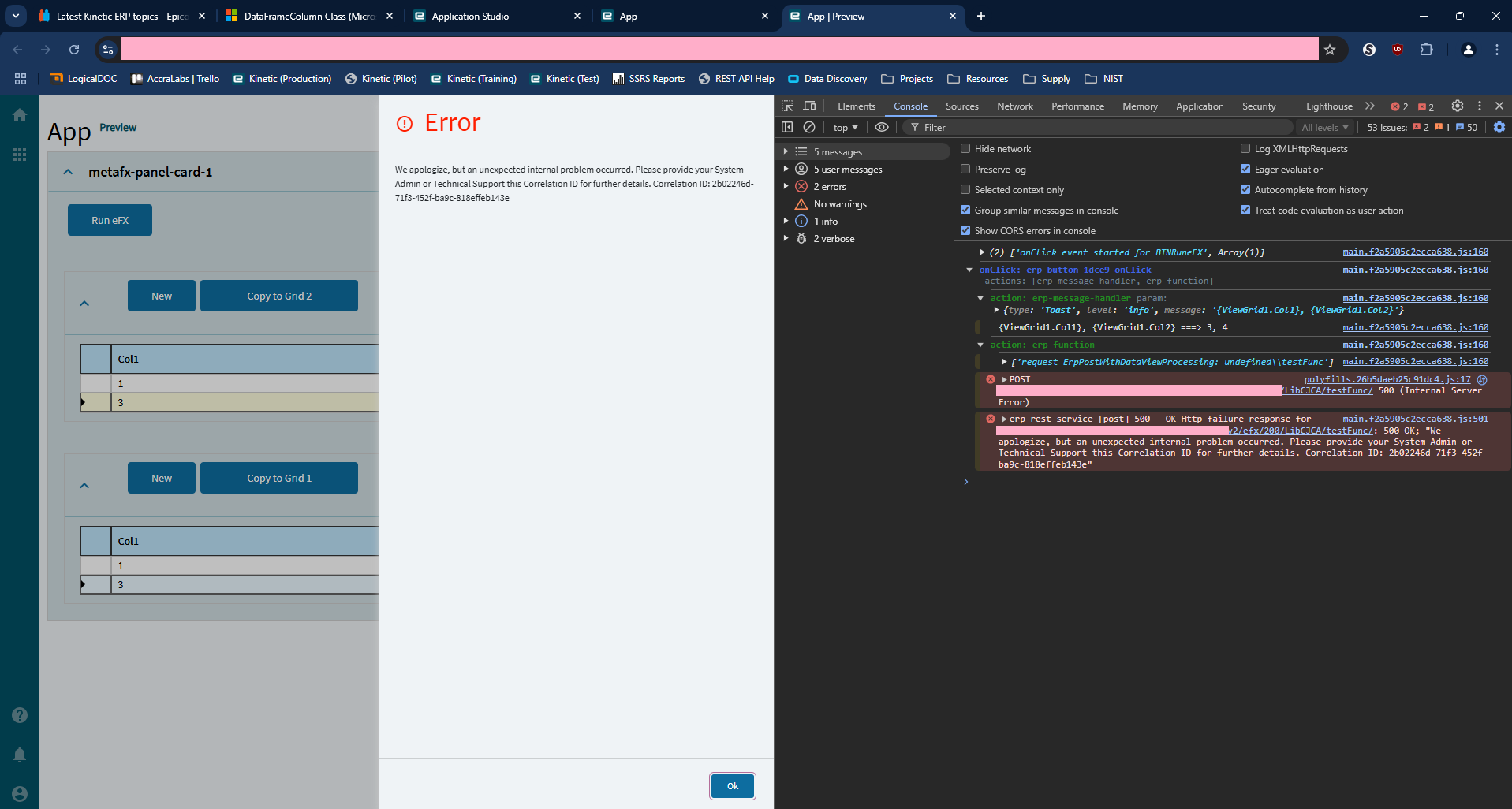

When called, I get a useless correlation error, and a couple events in my Console.
The toast message before is showing Col1 and Col2 from ViewGrid1, and the toast message afterwards should be showing actionResult.output1 and .output2, which isn’t happening.
I’m sure I’m missing something simple and obvious here, I’m pretty far outside of my usual scope. Unfortunately, the Kinetic reference guide entries for these fields are basically just what the tooltip says, so I’m reaching out to the experts. I’ve tried searching for several different permutations of what I’m trying to learn, but I haven’t found anything. I don’t need this specific function to work, but I do need to understand in the general sense what’s going on with function parameter return.
