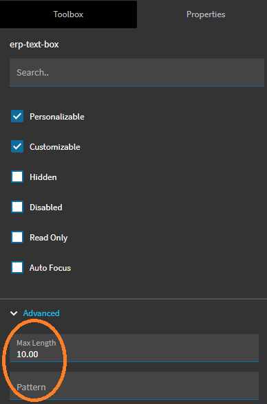

Anybody know when the Max Length, or Pattern fields are going to work?
Or do they work and I’m just dumb?
Max-Length seems to limit nothing.
Pattern is supposed to accept a regular expression, but all it takes is the characters:
0-9 . and -
0-9 . and -

I believe max length refers to the number of digits or letters. It must be used in conjunction with pattern else its ignored by the browser.
E.g 0-4 in max length
\d in pattern
Result
-9999 > 9999
Give it ago…

The pattern is full.

Can confirm does not work in 2023.1.6… or maybe I am just dumb as well
Also noticed in this version, in the Pattern setting for the textbox you can only enter numbers now (how in the hell are you supposed to enter a regular expression)
I just entered a case with Epicor Support on the Max Length, and it still does not work in upcoming 2024.1.3. Dev then tested it in 2024.2 and it does work there… so only 5 or so more months to wait.
Obviously my case was moved to suggested resolution.
