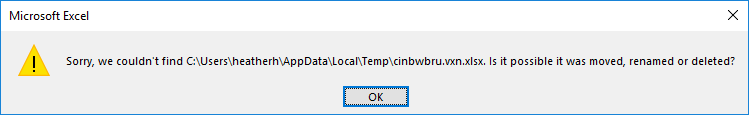

Just FYI, I was just trying to do some testing of this issue because well, it wasn’t an issue for us…until now. I am running E10.1.600.16 and Excel 2016 on my PC. Microsoft Office has been prompting me to update my version for a while now
but I’ve been ignoring it just so I could test this issue.
I’ve had no problems using the Copy to Excel feature from the Epicor 10 client until I installed the latest updates to Microsoft Office. I just applied the update and now I am receiving this when I use Copy to Excel:
So from my testing, it seems to me the update to Office broke my Copy to Excel somehow. I know Epicor is working on this but just wanted to report my findings.
Exactly what we saw here Heather. Like Epicor, Microsoft wants users to be on the most recent version of the software for easier support and better security reasons. It’s quite possible that this fix is security related. We have a process creating an Excel file in a temp folder which is then opened by the user. A malicious process could add macros to this file - disabled but waiting for an unsuspecting user to enable active content. So there may be another way to perform this task in a safer way. Just throwing out a possibility…

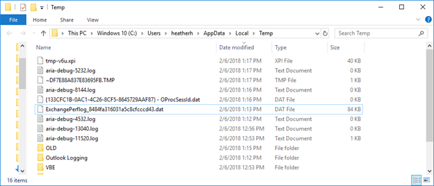

Anyhoo, I stumbled upon this because I was actually just trying to grab a print screen (using the old school Alt+Print Screen) to show the interesting behavior
of my, in this example, ittpg0hg.w0s.xlsx file getting created in the Temp folder initially when you click Copy to Excel.
Now you see it:
And then suddenly it disappears.
Now you don’t:
And then you receive the error:
SO yes it was deleted…but not by me silly Excel.
