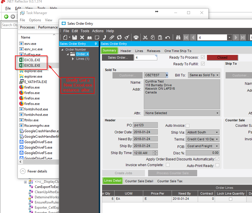

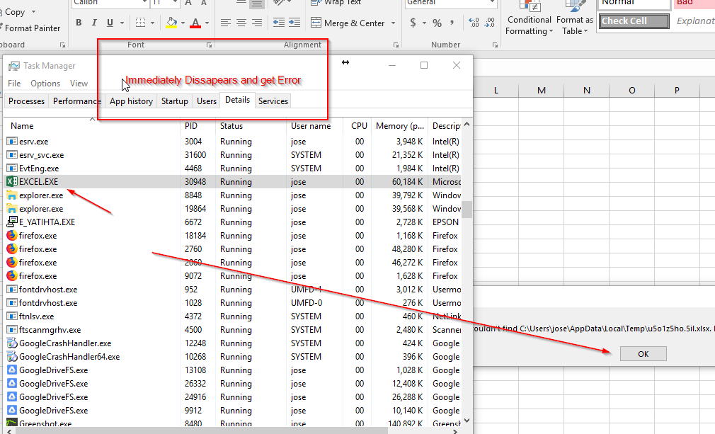

So I got curious as to who is at âFaultâ here (Excel or Epicor) and why does @ERPSysAdmin workaround worksâŚ
Ran Proc Mon (Handy Little Utility)
http://jcg.pictures/gdgfJP1X8Sc.png
Looks like our friendly Epicor creates the Excel file ⌠and then unceremoniously deletes its ![]()

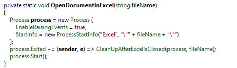

Further investigation yields that Epicor is perhaps not completely at Fault. Being âGood Citizensâ since they are creating a âTemp Fileâ they register an Event (intent) to be notified when Excel is Done with it (when Excel Closes) and then they run a CleanUp Utility to delete said temp file. Kudos EPICOR!!
The issue I think arises IF thereâs already an open instance of Excel, basically Excel on the Microsoft side is âCleverâ and says Hey no need to open a new one of those, weâve got one already and hands off the âHandlingâ of the Request to the existing Excel instance, which causes our newly started Process to âExitâ which then Epicor interprets as âClean Up Isle 6â
Heatherâs work around , works because holding down Alt tells excel that you want a âSpecialâ excel instance and thus Microsoft scoffs at you for wasting resources and lets you carry on your merry way with your ânewâ Epicor Instance.
This is all inference from looking at the code and process behavior but I think thatâs where the issue is at, Iâm curious if this can be replicated if there is absolutely positively no Excel.exe process already running⌠(I wasnât able to make it happen except when there is already an excel process running), but it could also be that Microsoft or Windows is firing the Exited event earlyâŚ
