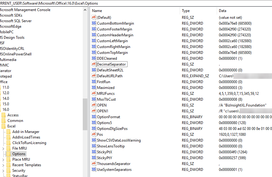

Jose, do you think all of those options in the registry export you attached are necessary? Or would it be just the key at the bottom: DisableMergeInstance
I’m making that guess based on all of the other keys are already present in the registry on my machine, which suffers from this affliction currently.
No, you only need the DisableMergeInstance one. Is the one I pasted.

Is there someone on 10.1.600.18-.21 that is willing to be an official tester of a potential fix for this issue? Only need one brave person to apply a hot-fix and test.
CONDITIONS:
You really need to be on a 10.1.600.18-.21 release–test environment is fine (and preferred).
You need to be able to duplicate the “copy to excel” issue.
SWEETENERS:
You’ll get one of my coveted gold stars
And more importantly, thanks from a grateful Epicor ERP community.
Just reply back to this post and I’ll send you the instructions on how to test.
I’m on 21. Testing the above and have not had an issue with Excel. I’ve opened the entire office crew to testing this out as the excel problem has been an issue.
So i have tried this fix on few PCs, and it was all great until one of the users had to copy formulas from one excel sheet into another and it wouldnt work. Only would copy the static value and no formulas.
Fingers crossed there is better solution coming soon
it only started when i added the fix, and formulas started to work ok as soon as i removed the key from the registry. Have tried it on multiple pcs as well
