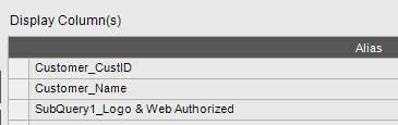

the baq that pivots with customer attribute description. I’m wondering if dashboard deployment dislikes the columns with space
maybe? FWIW, you haven’t given anyone any good information to go on here. Just one pretty generic error, and now a screen shot of the display columns. I’m not sure anyone would be able to diagnose your problem with that limited amount of information.
If you suspect that to be the problem, then troubleshoot it.

I’ve pinned the cause down to the “&” within the display column. I have a Pivot Dashboard I am trying to create with 50+ resource groups. 8 of those resource groups have an “&” and I am getting this same error 8 times when trying to deploy the dashboard.
