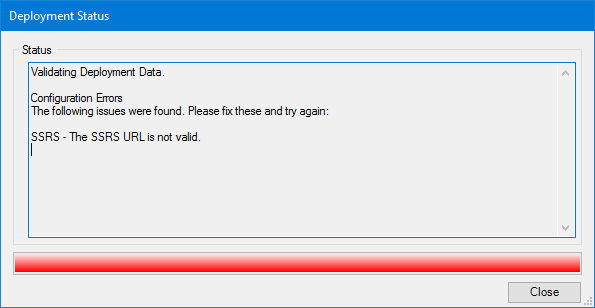

Trying to enable SSRS on an App that successfully deployed w/o SSRS Configured. But I get the following:
“SSRS - The SSRS URL is not valid.”
Which URL is that referring to?
The “SSRS Web Service URL”, or the “SSRS ReportServer Location”

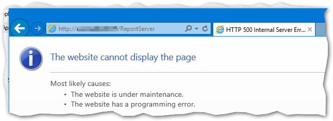

But if I enter the SSRS Web Service URL into IE on the App server, I get an HTTP error 500

I get the HTTP Error 500 when trying to get to http://xxxx00375/ReportServer while on the SQL server (\xxxx00375), too.

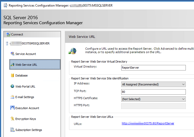

Go to the SQL Server box open Report Configuration Manager
and see what the Services URL is in that?
That’s where I got the URL from

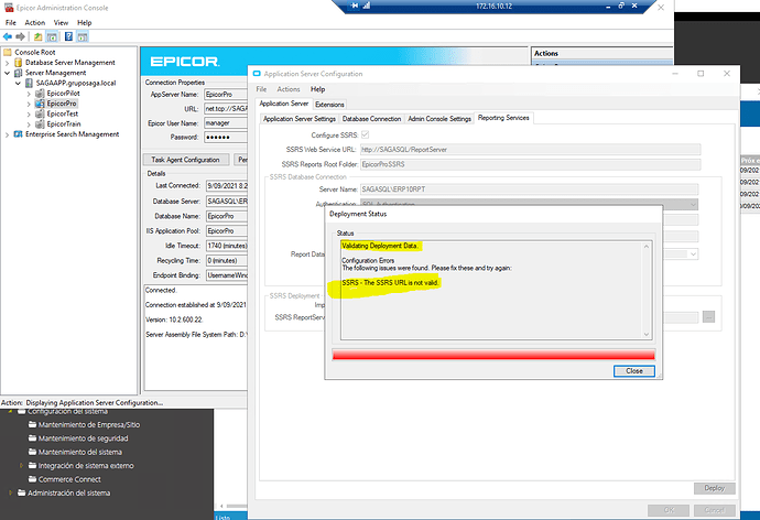

hola buenas tardes , por favor necesito ayuda con el tema mencionado…si me puedes ayudar le agradezco

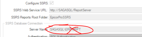

Oye Henry, por que usas el nobmre de la base de datos en este espacio?
Igual quitas eso.
Pero al final, con referencia a los que han escrito antes, es algo con el enlace final de “SSRS Report Server Location.”
Has llamado a Epicor ya? Tienen un equipo de instalaciones que pueden ayudarte.
y llame pero me dijeron que estaba dañado este archivo…pero como no era de problema de ellos no me podian resolver
Ninguno de tus instalaciones funcionan o solo este? Veo k tienes EpicorPilot, Test, y otros.

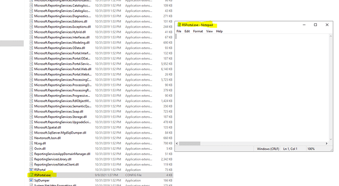

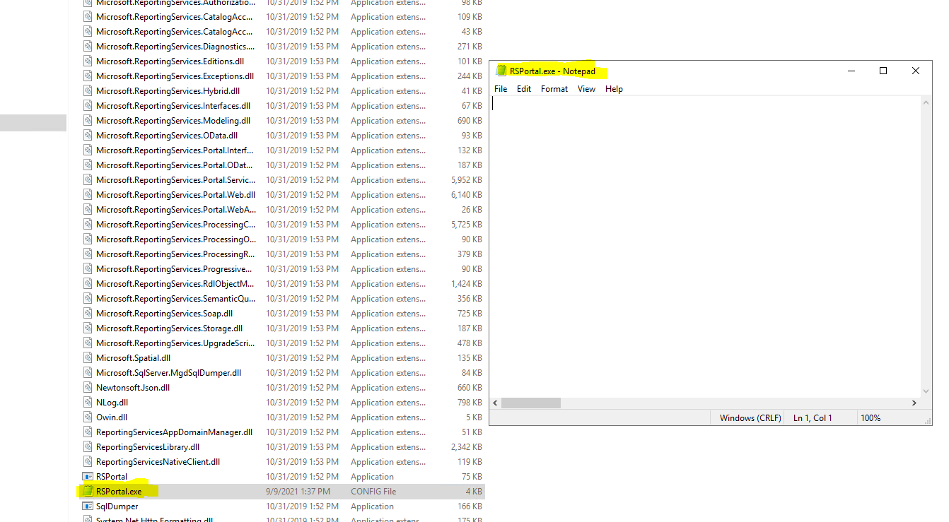

Is it normal for your executable files (.exe) to show with the Notepad icon?
Is your server is setup to always show file extensions in the File Manager?
I ask because the file displayed as “RSPortal” has type “Application”
the one that displays as “RSPortal.exe” may actually be RSPorta.exe.config, with files with the .config extension having Notepad as their default program.
Open “RSPortal.exe” (the one that looks like a notepad icon), and then hit CTRL+END. There might be info in that file it is just way off to the right side.
el archivo esta totalmente en blanco…puedes conectarse conmigo al WhatsApp al +573046338148

Calvin, I can’t tell if the issue is that reporting services were setup wrong on the SQL server or if the deployment is just failing because of a setting in the admin console… What is your take?
estaba funcionando todo sin inconvenientes…pero el dia de ayer se reinicio el servidor y desde ese momento tengo ese inconveniente …
  1. no me cargaba el servicio del SQL server reporting service…emplace el archivo web.config
    y luego se verifico y veo que tambien el RSportal.exe.config esta dañado…no tiene ninguna informacion
