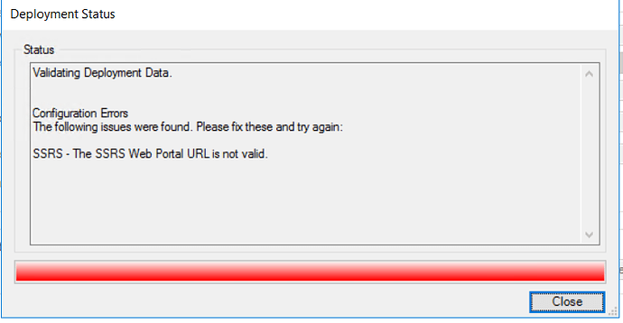

When I deploy my application, it fails with “The SSRS Web Portal URL is not valid”. E10 doesn’t ask, but the URL I got from my SQL server’s Reporting Services Configuration Manager works in my browser.

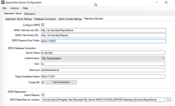

It should be /ReportServer at the top and /Reports at the bottom
What does your setup screen look like
@josecgomez I’m just rebuilding it again it, but exactly like that. I’m using a separate VM for SQL but the setup (aside from “Web Portal URL” which doesn’t appear in 10.2) is the same.

Edit - I was half-expecting it to just work this time because you asked, but same error:

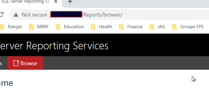

Edit - exposing my ignorance here - but the Web Portal URL copied and pasted into a browser opens the portal nad I suppose the “not secure” with no specifics means there’s no certificate?
