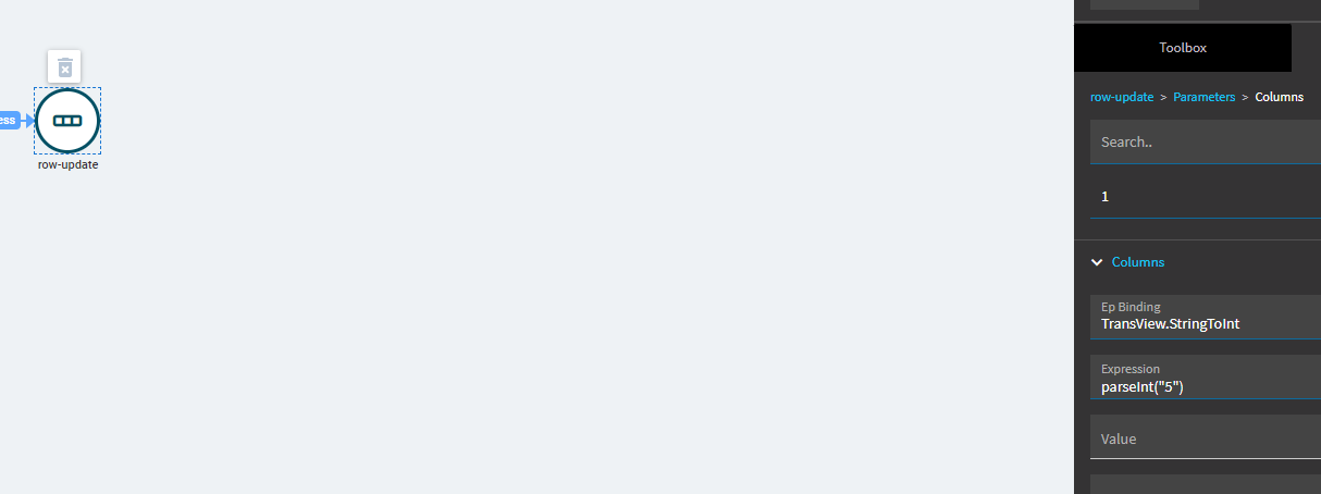

I would create a function that parses a string to an integer.
Call that function in your event, pass the string value into the function, then use the converted, returned integer to be your Value In param for the form open.
You could also do it inline with the row-update widget if you wanted.
Thanks for that, I still get the same conversion error, unless I’m doing something wrong?
The conversion itself works though!
So, when you run it and look at the DataViews in Dev Tools, it’s showing an integer value for TransView.StringToInt?
Correct!

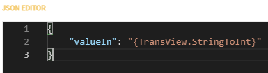

Remove the quotes from the JSON since it’s now an int:
    "valueIn": {TransView.StringToInt}
I do that and it gets a red squiggly line and says “value must be doublequoted”.
Can you try that and see if you get the same error?
So, you’re right–it needs the quotes despite the int.
