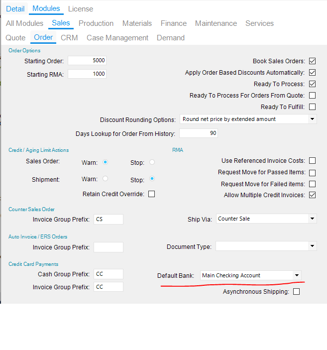

Thanks for reply. I can’t edit it because it is disabled. How can i enable the Credit Card Payment section

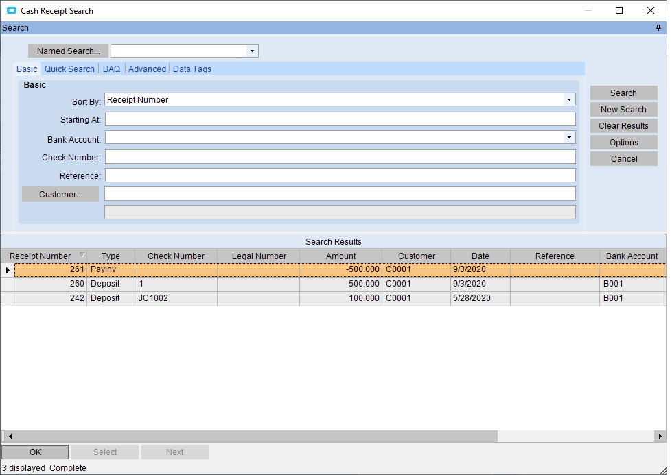

The Cash Receipt you are trying to reverse was created using the ERP? Or was it loaded from somewhere else?
I’m asking because the reverse should copy the BankAcctID from the original Receipt CashHead record, however in your case it seems to be empty so it tries to go through the default bank in the Credit Card section and it does require a specific license.
Hi, any idea to reverse it?
I don’t think transactions in Apply Credit Memo can be reversed, try Cash Receipt Adjustment.
