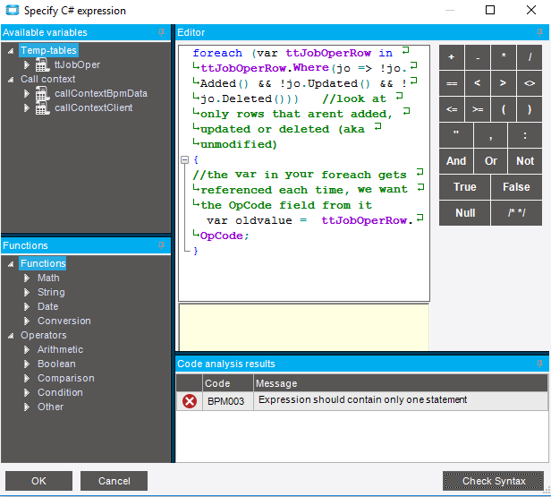

thank you very much for the clarification, similarly I still see the error.
annex an image.
The error is pretty clear. It doesn’t like that you have more than one statement in the expression. Expressions are meant to be a single statement. You have a loop inthere.
Hola Jose, muchisimas gracias por la aclaracion, vere donde esta el blucle
Like Jose mentions, the issue is you are trying to use an expression.What is your intention?
thank you very much for the attention, my intention to create this code and send it to call, is to show me also in the email that warns me of the update of an operation, to show me the operation that I had before it was changed.
