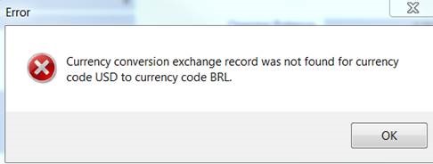

We’re seeing a very similar currency error message testing 10.2.100 in Bank Statement Processing. We also have a ticket in with Epicor. Our upgrade was from 10.0.700 through 10.1, so it certainly could be 10.1 related.
BankReconError1
