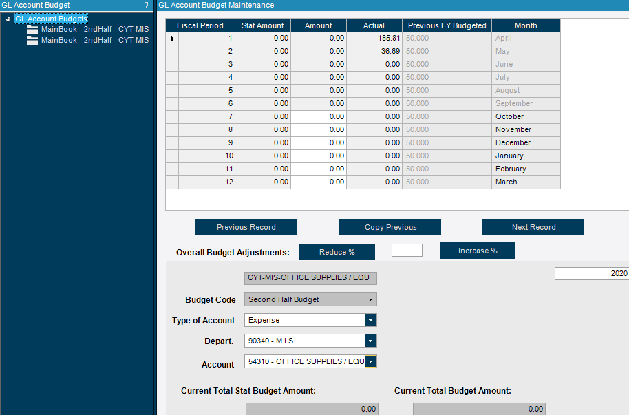

when one of these changes all my formatting gets reset.

the read only boxes as well values in the boxes.
When I switch between records the boxes I have set for read only on the first one then becomes writable, only when I switch between records tho

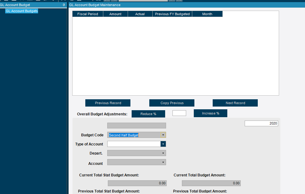

This is a new record
But when I switch my record on the side it removes everything like this

So am I able to do it like I have it here:
Cause this is the end goal right here, it would be nice if I could just remove them on left and replace it with the new one when they hit next record or previous record.
EDIT: So I can make full columns read only with the view, but now I am trying to loop through the first 6 rows and only make those rows readonly in a specific column like the picture I provided, Only way I can think about looping through the rows of the dataview was this “edvBudgetDtl.dataView[i][“BudgetAmt”].”

I got it doing it how I wanted to do it, I couldn’t use rules and set 6 rows to read only so I just only allow one search to be done at a time as my work around. I watched both of jose’s videos on the rule wizard and yes I can see how that can be extremely useful but in my case I was trying to make just the first 6 rows read only on one column and I couldn’t figure out how to do that with rules. Thank you for you assistance and the advice. I did learn something new today.
Is it always 6? that would be a very strange use case. I assume there is a criteria of why it’s those 6. If there is criteria for those 6 then you can use row rules. Glad you got it though
yes for 2nd half budget first 6 periods are read only and “locked”
Custom code condition on the row rule is what you would have wanted to use then.
