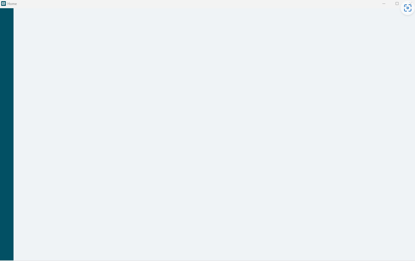

When I go into the Engineering workbench and try to execute ‘Get From Methods/Job/Quotes,’ a new window opens but remains blank.
Is this in 10.2 or some later version?
2024.2.10. Only one user getting this issue.
Any kinetic personalization for this user on that form… Perhaps it needs deleting…
We don’t use kinetic screens yet. We just completed our UAT for 2024.2.10 and found the same thing. I switched the user to “classic only” in his options and this took care of it for us. I know it’s not a resolution to your issue, but we did see the same thing.
Clear the browser cache - blank slide out windows are usually resolved by clearing cache in my experience.
