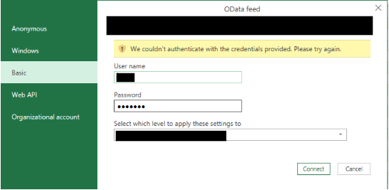

We use excel to build out some KPI and reporting to display in our environment but I seem to have a lot of authentication issues for the majority of my epicor users. All my users have access to BAQ’s they are able to run the BAQ’s in epicor that I am using for the report but when attempting to use their credentials for the ODATA call in excel they get the following error. This error typically also results in the users being locked out of their epicor accounts. Has anyone else seen this before?
