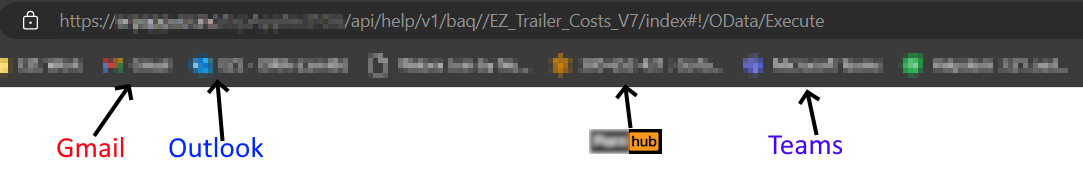

@CSmith - Who do you think you are fooling by blurring out your Bookmarks bar…We all see what you are doin’ over there :rofl:
@jhecker LOL Busted :smiley: Only one of the 8 profiles though :stuck_out_tongue:
OMG LOL I missed the ref there and not XXXHUB, but GoToMeeting lol :stuck_out_tongue: Guess you really only busted yourself @jhecker :smiling_imp:
Should have inspected your image edit much closer!
