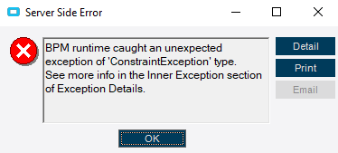

I changed the BPM to record the AssemblyName in Character01 in a UD record. I got an error. Just running the BAQ designer, I get the following error:
If I change it to:
callContextClient.AssemblyName ?? string.Empty;
Then that error goes away. So it’s NULL for both the BAQ Designer and REST.
