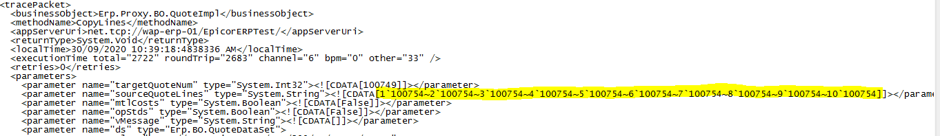

Hi, I am trying to warn users when copying quote lines where the configurator has been updated since the line was entered. I have managed to do this using a BPM for Duplicating a Quote, but when it comes to copying lines the sourceQuote and sourceLine are together in a string sourceQuoteLines;
Can anybody help with the code to extract the sourceQuote number and sourceQuote line into variables for use in my code.
