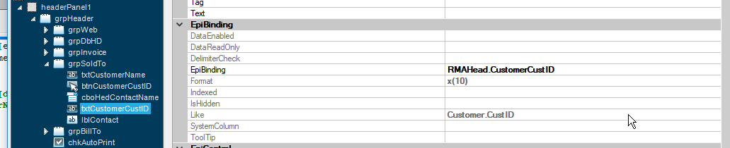

So that control is bound to RMAHead.CustomerCustID
So when you are changing the control, the control is changing the data view, it is triggered when you leave the field. So if you skip the field and go right to the dataview, you should be able to change the dataview directly, then run a notify to notify that it changed. Basically changing the focus is like turning your car right to turn the turn signal off, going to the dataview is like just turning off the turn signal.
