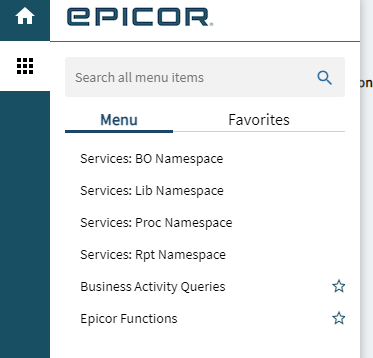

Step Three: On the left hand menu, select “Business Activity Queries”

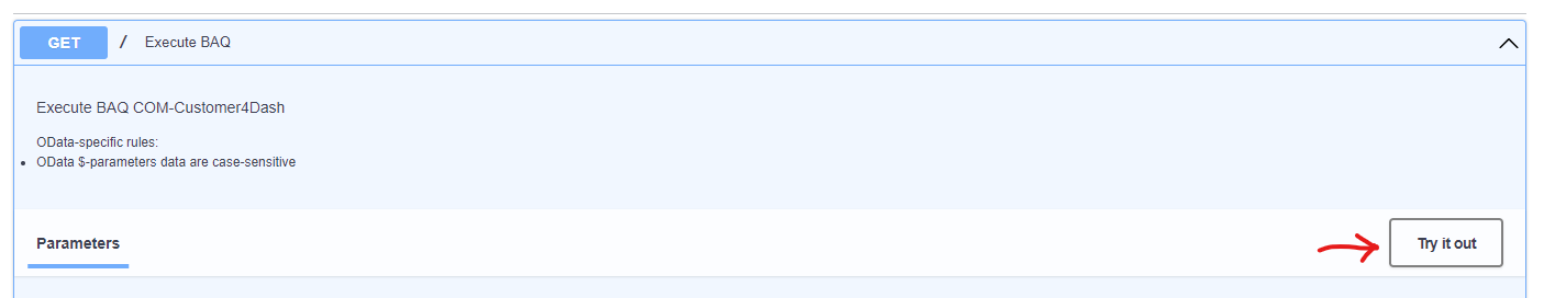

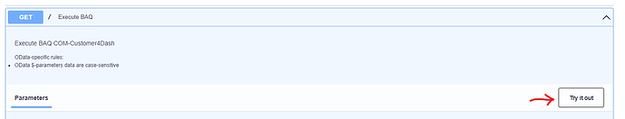

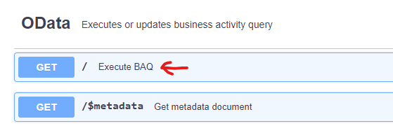

Step Five: After those options are selected, the next step is to create a link you can use to pull data into excel. You will do this by selecting the “Get” button next to the command “Execute BAQ”
Then you will select “Try it Out” below that-

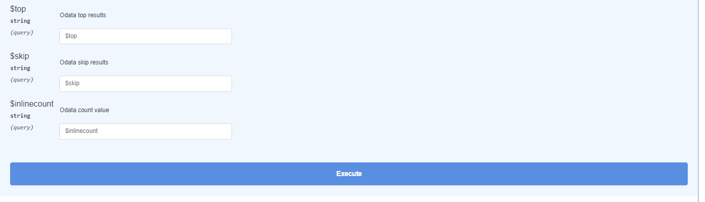

Then you click “Execute” below that-
You will then have a link that pops up below that under responses, with one being labeled “Request URL” This is the link that you need to have for Excel to pull the data. (Sorry, no screenshots of my url here)

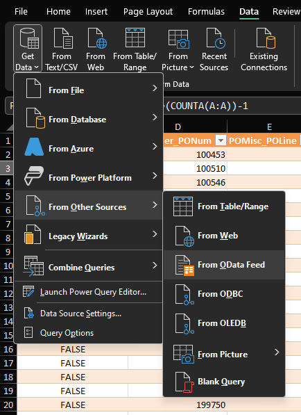

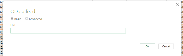

Step Seven: In Excel, go to your data tab. Then go to Get Data-> From Other Sources-> From OData Feed.
Step Eight: You will then be prompted to paste your link we received earlier from the REST API. Paste it here.

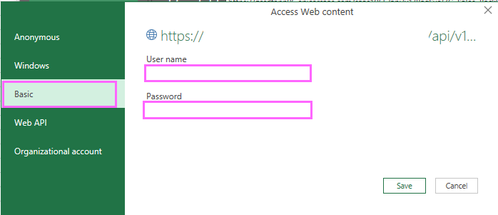

I only use V1 and have no issue using the built in Excel authentication window. I have several BAQ connected spreadsheets that are shared in the organization, and each user will enter their own credentials to refresh the data in this window:
