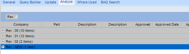

Can you help me with my BAQ? I’m trying to find parts that do not have a revision number assigned. When I do my query I end up with all the records, even if there is an existing revision. I only want to see parts that I need to DMT the initial revision to.
I’m receiving duplicate values and not sure how to filter them out.

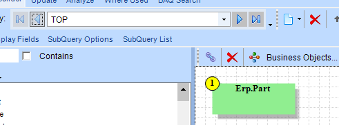

Maybe I need to do a sub-query or a row count?

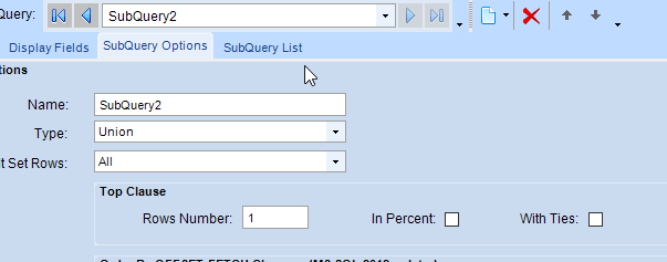

Try using an “Except” subquery.
Alright. Getting somewhere now. I’ll post result once i figure out this sorcery. Never used “except” before but its interesting.
Basically finding the difference between two identical queries with different criteria I believe.
Exactly. It will work like a Union query, but only provide the results unique to the first query.

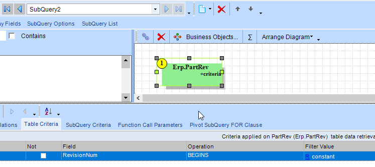

Issue I found is that when no revision exists, i dont believe there is an entry into the partrev table. It was helpful in finding mislabeled revisions. Our nomenclature is R00 R01 R02 …

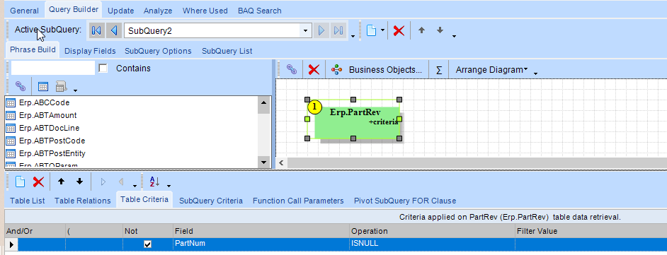

Would there be a way to compare Part.PartNum to PartRev.PartNum? the missing records are going to determine my parts with missing revisions.
I’ll try some other “Types” in the sub-query options.
This might be a better universal filter. Like i mentioned before, I dont think there is a row stored in PartRev table if the revision does not exist.
Using this criteria should help narrow it down.
