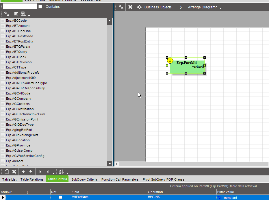

sub query (I’m filtering by part number starting with 721, stainless steel for us)

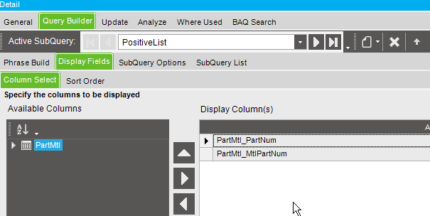

Sub display fields

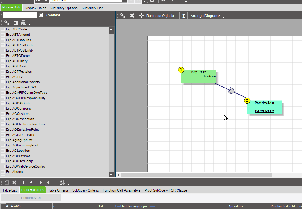

Top level tied by part number,left join (I also filtered my part master list a bit as we have over 10k part numbers)

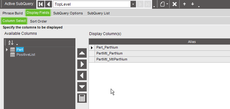

Top level display fields

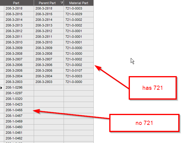

Here are the results, the list with nulls in the sub fields are parts with no 721 numbers in them.
