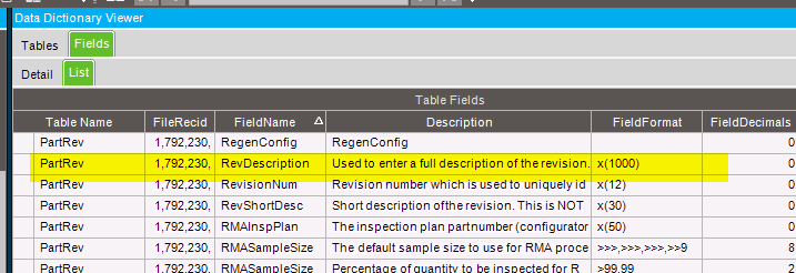

Finding the true column width for a comment field
In the DMT template for both Part.MfgComment and PartRev.RevDescription – they each specifiy x(16000) as their column widths. However, when a BAQ is created with these columns, the field width is x(1000).
So… how do I know EXACTLY how wide these columns actually are?
Is there a table “describe” command allowing me to get a true column width?
When I do a max(len(revdescription) on the partrev table, my largest value is a little over 2800 characters wide so I know the column is definitely over 1000.
Any tips are appreciated – thanks!
Karen
Check the data dictionary.

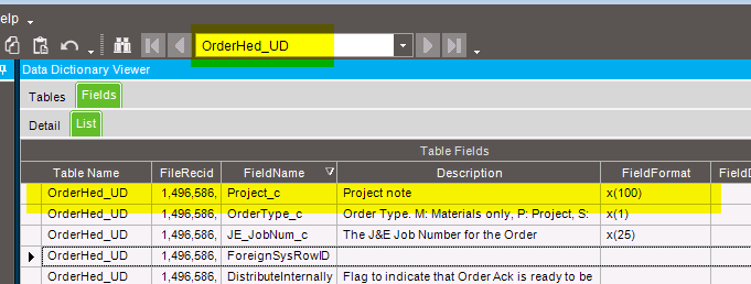

And if it is a UD field, make sure to open the table with the _UD suffix.
x(1000) is actually Max. So it can be larger than 1000.
