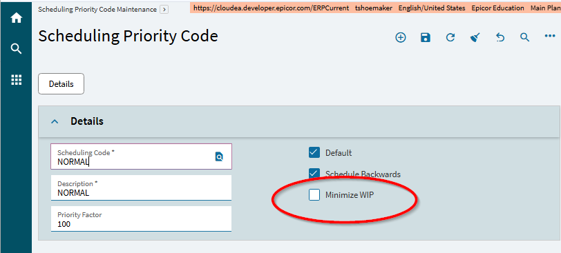

AH.. there is a “Minimize Wip” setting available in the Scheduling Priority Codes table… yours is probably turned off for your “normal” scheduling just like mine is. If you turn it ON, then after the system does a forward schedule (due to not allowing historical schedules), the system will do one final pass on the schedule, and will backward schedule it from the final finite capacity schedule.
In other words… if you have a due date of Nov 1, and you schedule the job finitely, and the system says “no, you cant have that until January 1”.. the system will then turnaround and do a backward schedule with a finish date of Jan 1, and will compress all the operations to be completed as late as possible while still meeting the January 1 date.
This didn’t help our situation. It actually made it worse because with that box checked, I cannot manually schedule operations in the various scheduling boards. Now if I try to move one operation in early and leave the remaining ops where they were, the system has all ops “locked” together. we use this to run jobs on our finite resources if we have a gap, but we don’t want the subsequent infinite resources scheduled earlier than need be to meet customer demand. Not to mention, when we ran MRP last night our original problem of the big gap between to first two operations is still there on MRP jobs.

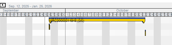

Still seeing the same thing:
The first op is supposed to take 13 minutes.
Looking at the shop load for that week ( the 22nd ), there are 2.87 hours remaining. I don’t understand why it’s putting this op “today” and not on the day in question (1 hour available on that day).
