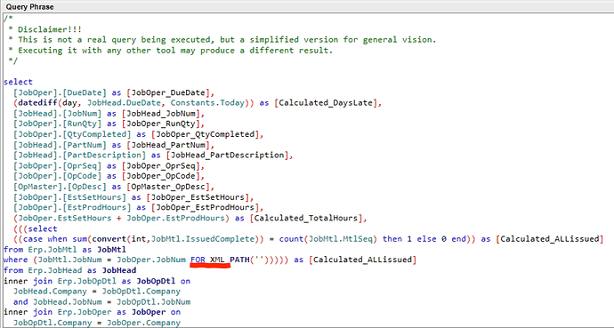

My problem is, I can’t find anywhere in the BAQ that FOR XML is used except for when I go to the GENERAL tab and look at the SQL query being generated:
So my question is, how do I atually find that and replace it? It is not in any of the filters and not in any of the calculated fields. I don’t know where it is hiding for me to replace it!

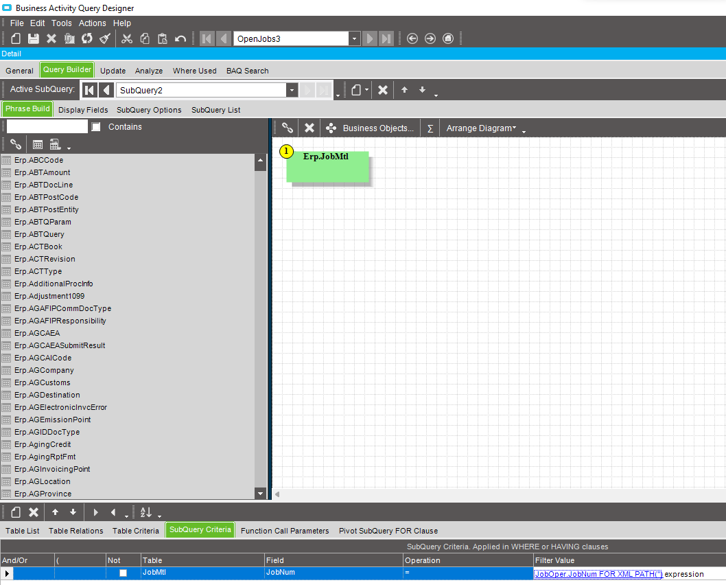

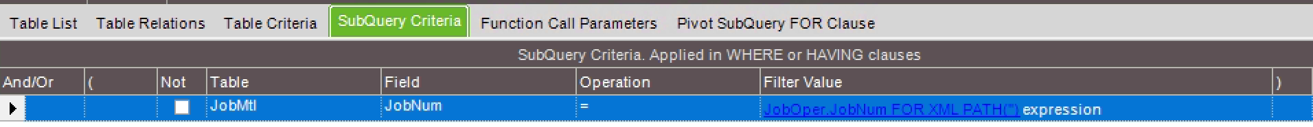

It’s in the Subquery criteria for Subquery2:
I saw that the FOR XML was in a Where clause inside something called AllIssued, so I looked for that calculated field and saw that the value was coming from Subquery2. I then looked at the criteria since it was in a where clause in the SQL text.

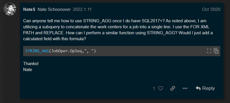

FOR XML PATH versus STRING_AGG - ERP 10 - Epicor User Help Forum (epiusers.help)
Thank you Mark but I read that before posting my question. It doesn’t provide an an example of FOR XML code that was in use and what it was replaced with, so I am still unsure how to do it. I also tried the workaround in that thread for Execution Settings but that doesn’t work either.
Are you just getting a comma separated list or are you doing something different?
And that code is replacing what code? Like I said, I already read that thread. Re-posting the same thing several times over isn’t helpful. I’ve already read it several times.

It is being used as filter criteria in this way:
Are you able to interpret what that is doing from that? I sure don’t get it.
