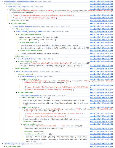

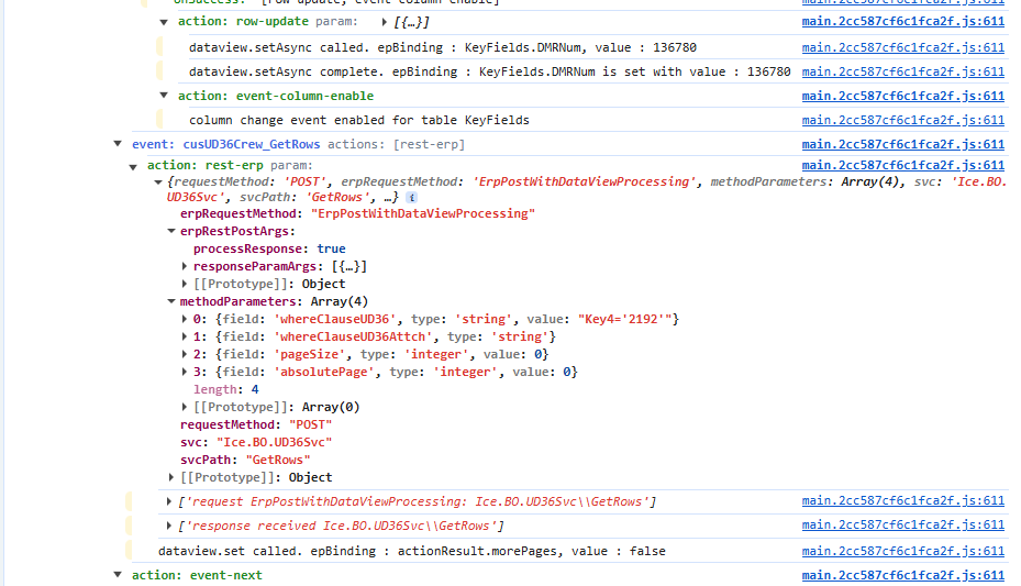

I also tried the event Update_KeyFields_ViewName after and check this out.
I’m using the KeyFields dataview in this example. I don’t get it.
Well, that event could be part of the problem:
Basically it is disabling any events triggered by changes to the KeyFields dataview.
It updates KeyFields.DMRNum with the value from DMRHead.DMRNum…
Then re-enables events for the KeyFields dataview.
So… any onChange event for KeyFields.DMRNum isn’t going to fire.

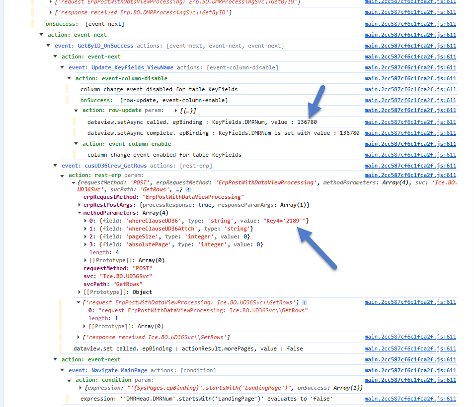

Try that same trigger… but use '{DMRHead.DMRNum}'
It used the correct value to update KeyFields.DMRNum… so, perhaps firing your event here is okay… but pass DMRHead.DMRNum instead.
Same thing.

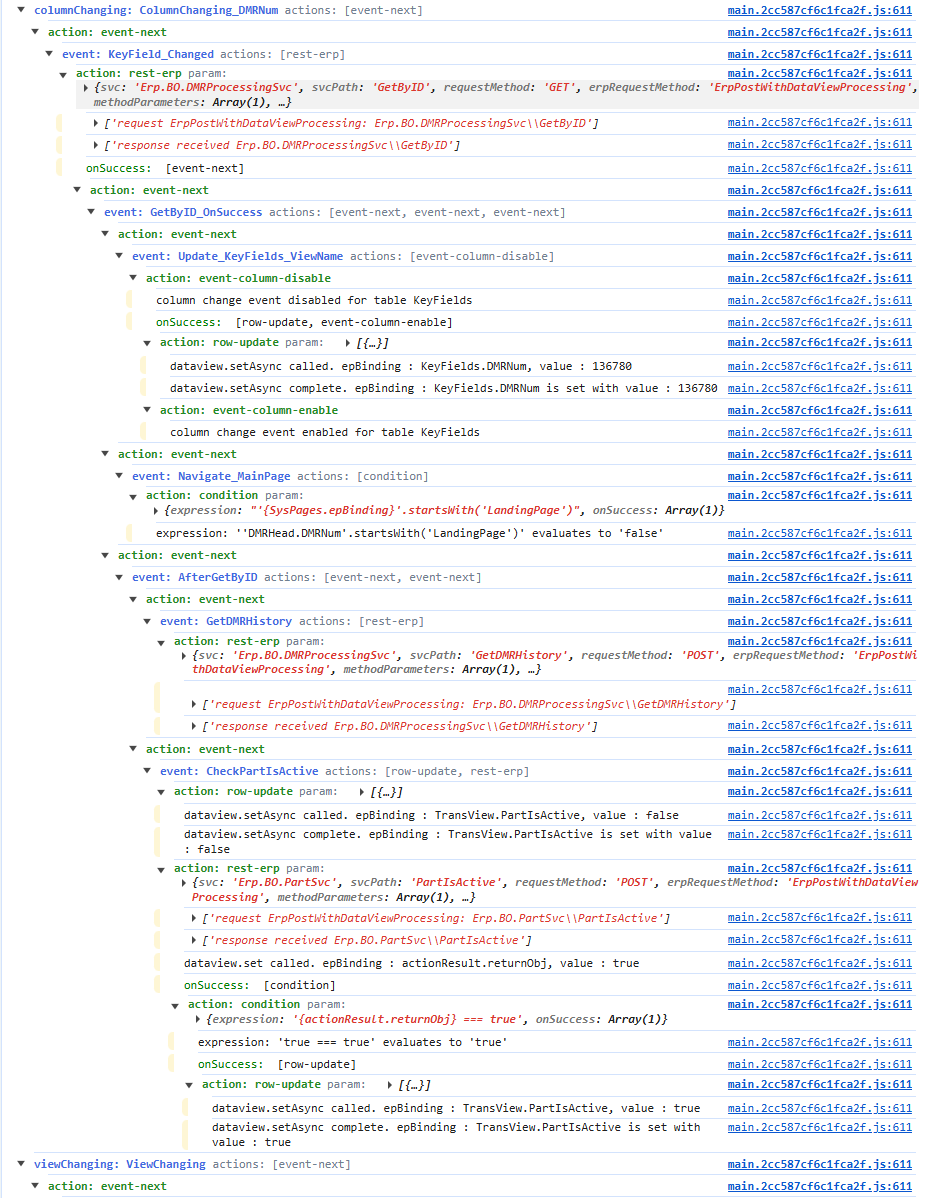

Okay… so let’s test my original theory.
Set your existing event to NO trigger.
Create a new event with a trigger of afterAfterGetByID (if you want to try that one again).
In this event, add an event-next to call your original event.
Its holding on to the previous KeyFields.DMRNum value. Possible it is grabbing context values when the initial event kicks off (including KeyFields.DMRNum)… and event though it is updating the value… that value isn’t being committed until that full event chain (including “after” events) complete.
I’ve seen before that splitting things out with event-next creates a clean break. Almost like it forces values to be committed prior to the “event-next” event starting.
This was never a problem in the past… but lately I’ve seen this work a few times. Worth testing.
That worked! WOW!
