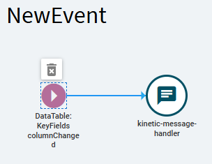

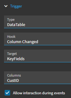

I want an event that triggers when the customer ship to* being viewed in customer entry changes. No matter what event I am choosing for my before/after/override (I’ve tried them all) trigger, I only ever get the customer ship to* number for the first record I open off the landing page. No matter how many times I go back to the landing page and select a new record, I still get the same customer ship to* number. Even though I see the event I am using as a trigger is using the same binding as I am, and is getting the correct value.
This is driving me insane, I don’t even understand how its possible. At the very least it should only lag by 1 value and use the customer number that was just closed. I cannot for the life of me understand how it gets the first record ever opened.
How would I even go about troubleshooting this issue? I’ve tried a number of events as the trigger, right now I am using the last event to appear in the debugging window after opening a record as my trigger so its as far down the chain as I can get.

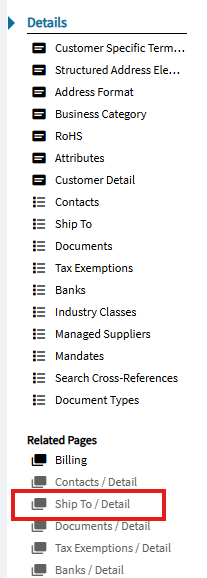

When I first open a customer, there is nothing in the ShipTo dataview. Note the ShipTo/Detail is greyed out.
It is not until I interact with the ShipTo table that a couple different events fire .

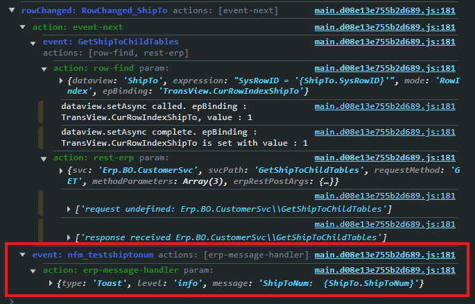

There is a RowChanging_ShipTo and a RowChanged_ShipTo event which both fire and populate the ShipTo dataview.
This sets the value of TransView.CurRowIndexShipTo to the corresponding row number on the ShipTo dataview (starting at row 0).
When I first load a customer, that transView column doesn’t even exist. Once I start interacting with ShipTo… that value is set to (0).
Changing rows in the shipTo dataview will update the value to (1), (2), etc.
I’m not sure what you’re trying to do with your custom event (setting/updating, etc.)… but perhaps exploring value being held in TransView.CurRowIndexShipTo may help?

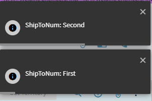

Even if my event is as simple as a messagebox with the current ship to id and the trigger is RowChanged_ShipTo I get the wrong value in the messagebox.
I was able to do it After RowChanged_ShipTo:
I can toggle back and forth and it pulls the correct ShipToNum into my message.

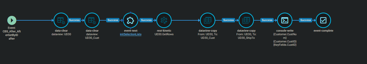

Still fighting with this type of issue. I see in the network tab it sends the previous CustNum, but the console prints the new, correct one. Same if I use a dialog show before the rest call. I tried deleting the rest call and remaking. No use.
I would recommend trying to split your event into multiple and using “event next(s)”. I know you’re using on-success between most of your actions, which, yes, should work… but I’ve found if things don’t fully resolve… putting them in a new event and calling that event on-success of the previous tends to work.
I can’t tell where in your event chain a good place might be for this break. But, its something you can experiment with.
That worked. And it was splitting it that was the fix, I copy pasted the widgets so it wasn’t the properties on those being messed up.
