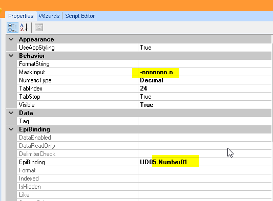

You’re using a TextEditor. Try a numeric editor and use the MaskInput field
scline
(Sharla Cline)
November 25, 2019, 8:49pm
5
Ah! That makes much more sense.
Thank you!
ckrusen
(Calvin Krusen)
November 25, 2019, 8:56pm
6
FYI - Numeric Editor fields don’t automatiaclly use the Extended Property’s format
The format of UD05.Number01 is set to ->,>>>,>>9.9999
Three controls (a txt editor, and two num editors) all bound to UD05.Number01
a. the two num editors with different InputMasks
