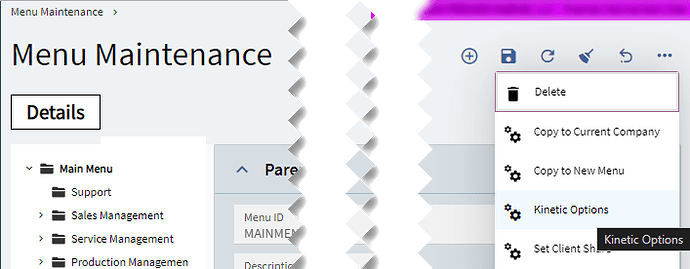

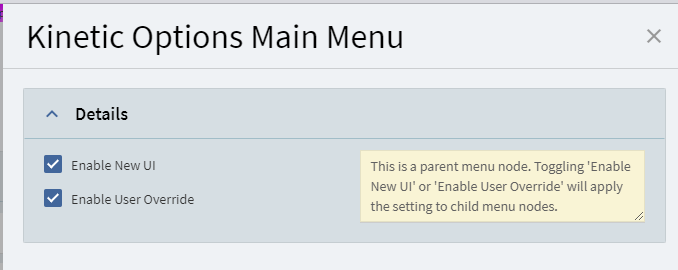

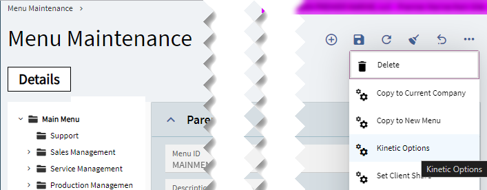

When you go to the main menu in Kinetic there’s an process under the “kabob”
This can be selected at the various levels - if you want to just update Finance select the finance management level first.
This allows you to turn on or off the Kinetic screens…

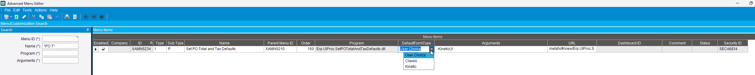

Here is our dashboard for managing menus exported from 2023.2. I mostly use it for deploying customizations. Historically Epicor’s Solution Workbench is dog shit for handling menu changes.
AdvancedMenuMaint.dbd (173.7 KB)

@LarsonSolutions - No way! So that’s where the old Kinetic Application Maintenance went. That’s a great tip, and will make moving full folder paths much faster to Kinetic.
In Classic-speak, the ‘Enable New UI’ checkbox sets the FormToUse to ‘URL’ - e.g. Kinetic.
‘Enable User Override’ sets FormToUse to ‘Default’ - e.g. User Choice.
And if neither are checked, then FormToUse is ‘Base’ - e.g. Classic.
