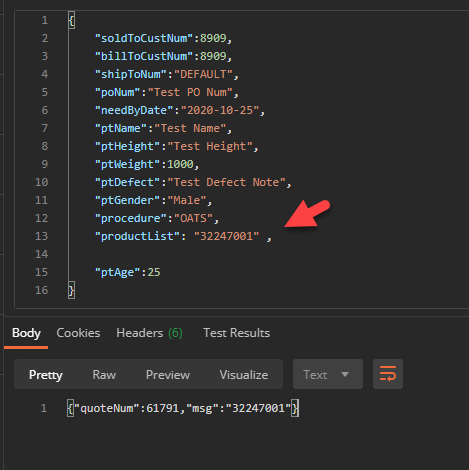

I have a function that has a string parameter intended to consume information related to what will be line level details in a quote or sales order.
The parameters for the function look like this:
the “productList” is filled out by a nested array like so:
Is this invalid JSON or something? I think it looks fine but more eyes are helpful.
next, when I consume this parameter, I was having trouble iterating over it as it keeps throwing back the “Sorry! Something went wrong” message to my app.
I am trying to debug this bug it’s not even allowing to read the incoming productList parameter into the output parameter “msg”
This always results in an error.
If I se the productList param to a single, non-nested array value, it works just fine.
Is there something preventing a JSON array from being read into this function? Surely it’s something small, but thanks for any input

I’ll do a little more investigating tomorrow and try some of those things, thank you. I do know it works great with single values

In this example I’m not even processing it yet. I’m just trying to figure out if it is being consumed at all into the function.
I also tried deserializing it and then displaying it in the msg output variable, but no dice.
So I tried then to not deserialize it in hopes that jt was being fed a raw json string and that fails too.
It looks like like it might be trying to parse it to a .net type without me knowing and perhaps that’s why it is not allowing it to be consumed if it’s anything other than a string or an int
