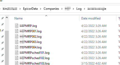

The log files are on the app server. Ours are here:
D:\Epicor\EpicorData\Companies\YOURCOMPANY\Log\mbelshaw

Your MRP logs are in your Epicor Data folder on your app server under Companies\Log\your user name, or you can use the retrieve server log function inside Epicor. The logs are really only useful if you have set the logging level to MRP though.
Here’s what it looks like on mine:
You specify the filename when you run the process. Process MRP runs jobs activities and PO Suggs.
