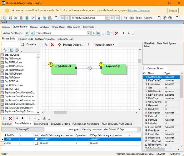

left outer join  (select
	[JCDept2].[JCDept] as [JCDept2_JCDept],
	[JCDept2].[Description] as [JCDept2_Description],
	[EarnedHours].[LaborDtl_PayrollDate] as [LaborDtl_PayrollDate]

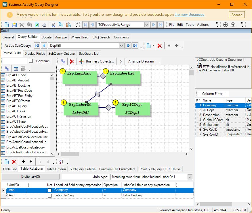

from  (select
	[LaborHed].[Company] as [LaborHed_Company],
	[JCDept1].[Description] as [JCDept1_Description],
	[JCDept1].[JCDept] as [JCDept1_JCDept],
	[LaborDtl1].[PayrollDate] as [LaborDtl1_PayrollDate],
	(sum(LaborDtl1.LaborHrs)) as [Calculated_LaborHours]
from Erp.LaborDtl as LaborDtl1
inner join Erp.LaborHed as LaborHed on
	LaborHed.Company = LaborDtl1.Company
	and LaborHed.LaborHedSeq = LaborDtl1.LaborHedSeq
inner join Erp.EmpBasic as EmpBasic on
	EmpBasic.Company = LaborHed.Company
	and EmpBasic.EmpID = LaborHed.EmployeeNum
inner join Erp.JCDept as JCDept1 on
	LaborDtl1.Company = JCDept1.Company
	and LaborDtl1.JCDept = JCDept1.JCDept
group by [LaborHed].[Company],
	[JCDept1].[Description],
	[JCDept1].[JCDept],
	[LaborDtl1].[PayrollDate])  as DeptEff

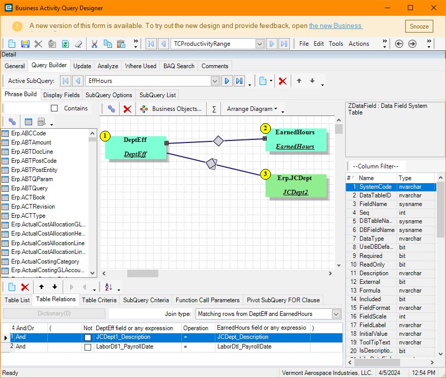

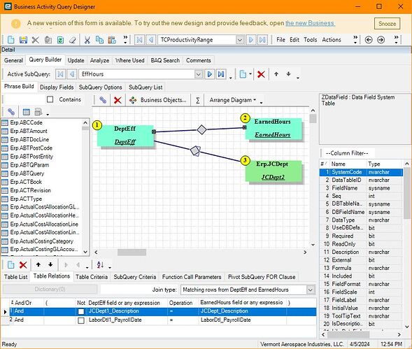

inner join  (select
	[JCDept].[Description] as [JCDept_Description],
	[LaborDtl].[PayrollDate] as [LaborDtl_PayrollDate],
	(sum(LaborDtl.EarnedHrs)) as [Calculated_ProdEH]
inner join Erp.JCDept as JCDept on
	LaborDtl.Company = JCDept.Company
	and LaborDtl.JCDept = JCDept.JCDept
group by [JCDept].[Description],
	[LaborDtl].[PayrollDate])  as EarnedHours on
	DeptEff.JCDept1_Description = EarnedHours.JCDept_Description
	and DeptEff.LaborDtl1_PayrollDate = EarnedHours.LaborDtl_PayrollDate

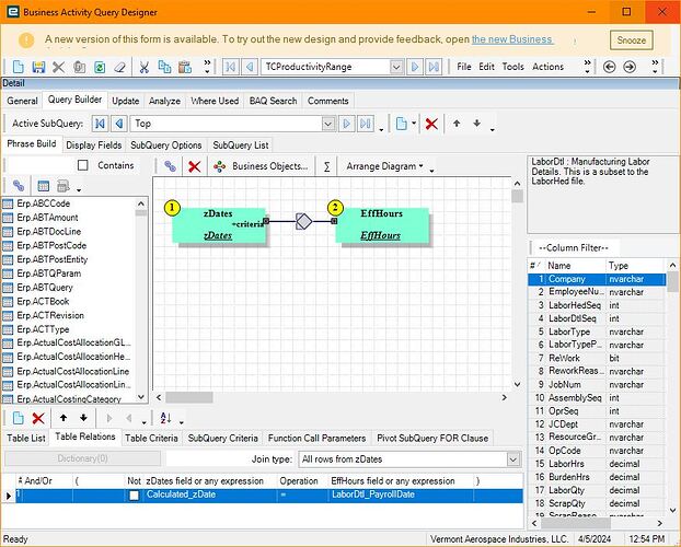

right outer join Erp.JCDept as JCDept2 on
	JCDept2.JCDept = DeptEff.JCDept1_JCDept)  as EffHours on
	zDates.Calculated_zDate = EffHours.LaborDtl_PayrollDate
where (zDates.Calculated_zDate >= @StartDate  and zDates.Calculated_zDate <= @EndDate)

Here’s one - inner join Erp.LaborHed
Also the inner join on your EarnedHours subquery.
I tried converting those inner joins to outter joins to the JCDept Table, but it did not change the output.
Ah, I missed that everything’s nested then joined on the date values. I’d cross apply* the departments on the date, then outer join the labor outside all the nesting.
* I wish cross/outer apply worked in BAQ. You can join departments on dates where 1=1 in this case.
