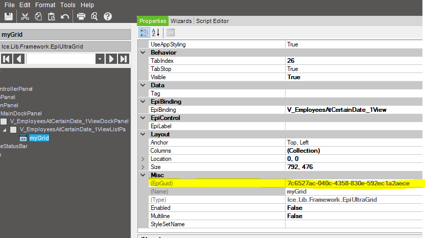

How can I find the EpiGuid of query grid?
Go into customization mode, then you can find the grid in the list of the tree view, and find the GUID on the properties tab. You can also click a grid then go to the properties tab (while in customization mode)
Yes, but developing a Dashboard I can only customize the Tracker, but I can’t customize the Summary that contains the grid
imatge
If you haven’t already, will need to deploy the dashboard as assembly, create a menu item for it, then launch the actual dashboard in customization mode.
