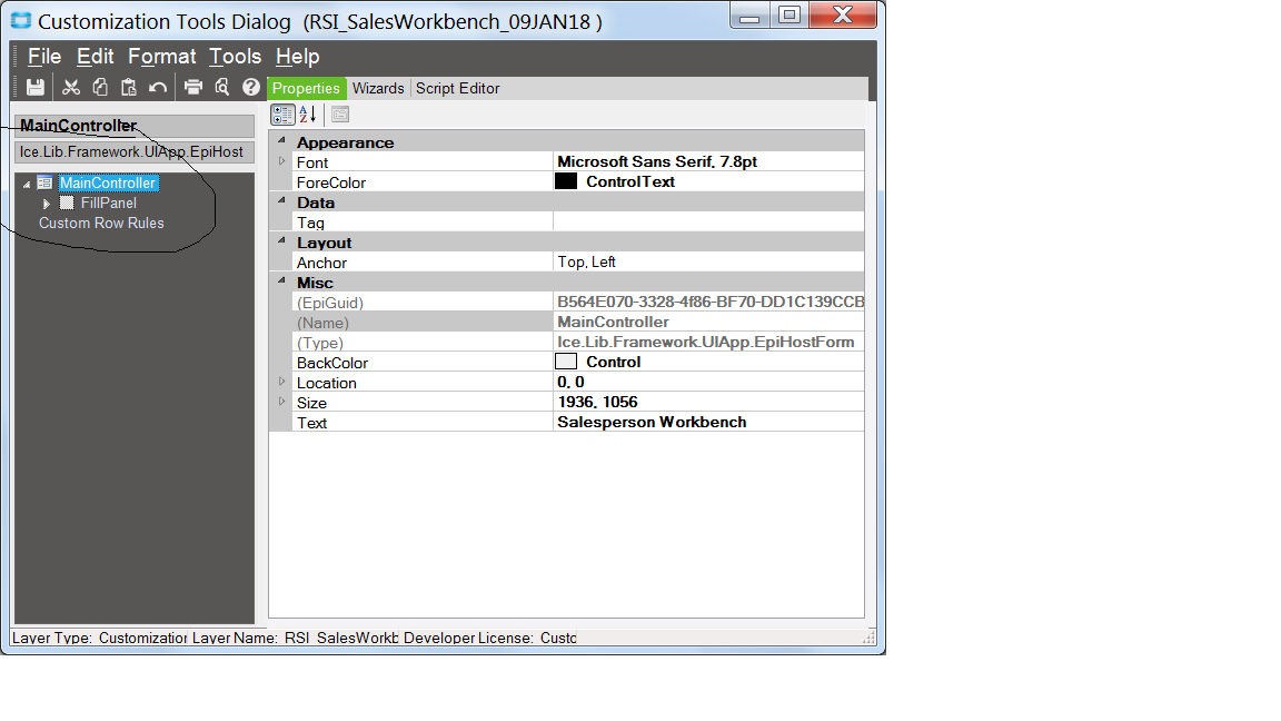

It’s saying that the object MainController, does not contain the member you are trying to reference (baseToolBars). You can either look at the hierarchy in customize mode, or in decomp to find the correct name of the object you are looking for.
MainController is the name of the form
Code in the script compiles successfully. The error mentioned is at run time.
That form is an EpiHostForm. The tool manager is:
this.ToolManager = AppPanel.MainToolManager;

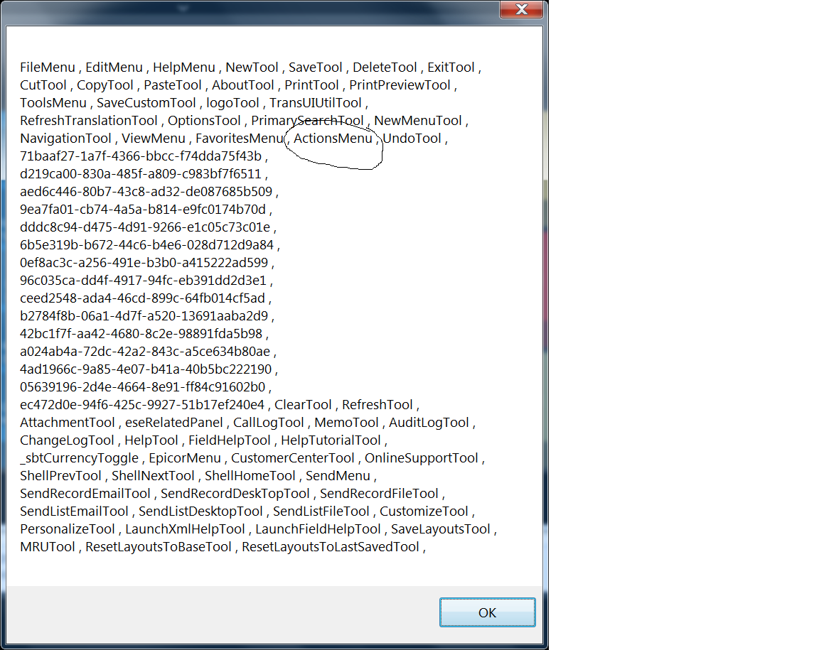

try:
var obj= MainController.GetType().InvokeMember(“ToolManager”…
Thank you. This worked
but I need to know the names of the menus under the ActionMenu:
I need to disable specific drop down items under the ActionMenu. What shall I used in the call MainController.GetType().InvokeMember(“ToolManager”…
