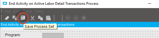

How do I make an item in the Tool bar inactive or hidden? I am opening up this menu item up to the business but I dont want them setting any process sets.
You’ll need to figure out the name of the tool, but you can just use something like
