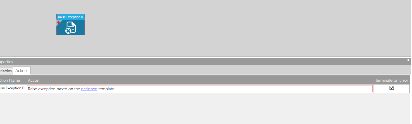

You could create a method directive against it and throw an exception.
Or Process/Service Security could also be used against that method.
Thank you Chris. that make the trick.
Thank you Nathan,
I´ve just created a method directive and that did the trick, later today I will try the process/security option.

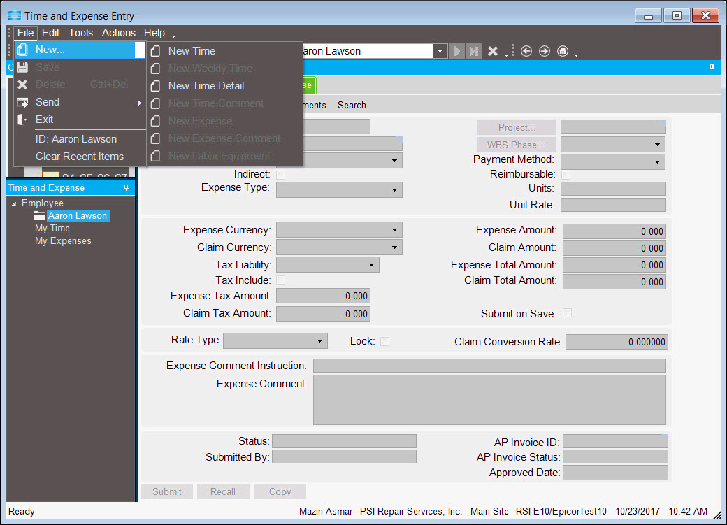

If you want to just disable the menu\tool
requires these using statements:
using Infragistics.Win.UltraWinGrid;
using System.Reflection;
In this example I am on TimeExpenseForm. You must know key of your tool
	var obj= TimeExpenseForm.GetType().InvokeMember("baseToolbarsManager", BindingFlags.Instance | BindingFlags.GetField | BindingFlags.NonPublic, null, TimeExpenseForm, null);
	var tools = (Infragistics.Win.UltraWinToolbars.UltraToolbarsManager)obj;
	if(tools.Tools.Exists("CopyTool"))
 		tools.Tools["CopyTool"].SharedProps.Enabled = false;

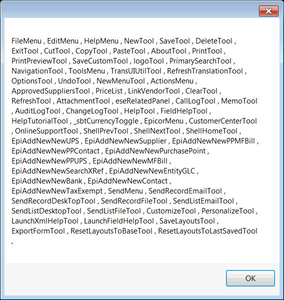

In a pinch you can get a list of a all tool names
string toolnames = "";
forearch(var t in tools.Tools)
    toolnames += t.Keys +" , ";
MessageBox.Show(toolnames);

No code required. Create a Method Directive on the desired method you want to stop.
Add Exception block
Set params and make sure Terminate on Error is checked

Should be t.Key not t.Keys.

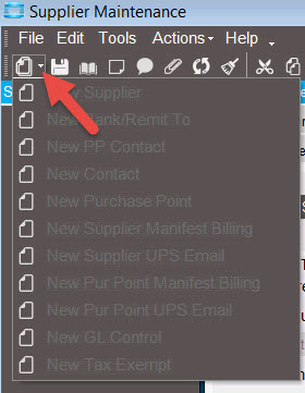

I am trying to replicate your form customization code for the Time and Expense form. I am able to get the list of main menus using the code you provided. Very Nice. However, in your case you disabled the copy tool? I am running 10.1.400 and I don’t see the CopyTool. In my case, how will I get/reference the list of sub-menu(s) and all items such as New> New Time …using the example you provided?
I placed the code you provided in the Form load event and that produced a much longer list of menu items. This maybe the root cause of my issue.
Wow its working know. I tested this from the Supplier Maintenance screen (load form event). I confirmed that the menu “New Suppliers” does get grayed out from the File> New> New Supplier and from the File icon (blank sheet) menu drop down. However, if you click on the blank sheet (not drop down arrow) a new row iemptysheeticonmenuemptysheeticonmenu2s inserted for a new supplier.
